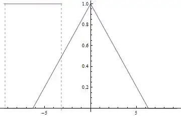

The problem of evaluating the integral above reduces to evaluating the convolution of two very simple functions having finite support. The following picture illustrates what needs to be done:
conv
Here, the rectangle (i.e. $\hat{f}(u-u')$) moves from left to right along the $u'$ axis, while $\hat{g}(u')$ stays fixed. The convolution at a particular value of $u$ is the overlap area. The form of this overlap area will vary depending on the value of $u$. For example, it should be clear that the overlap area is zero when $|u| \gt 3 \pi$. (The near edges of the rectangle lie outside the triangle.)
Now, when $u \in [-3 \pi,-\pi]$, the overlap area is a right triangle extending from the left vertex of the triangle to the right side of the rectangle (see the figure above). That is,
$$\begin{align}I(u) &= \frac{1}{4 \pi} \int_{-2 \pi}^{u+\pi} du' \left ( 1+ \frac{u'}{2 \pi}\right )\\ &= \frac{u+3 \pi}{4 \pi} + \frac{(u+\pi)^2-4 \pi^2}{16\pi^2}\\&= \frac{1}{16 \pi^2} (u+3 \pi)^2 \end{align} $$
When $u \in [\pi, 3 \pi]$, the situation is the mirror image:
$$\begin{align}I(u) &= \frac{1}{4 \pi} \int_{u- \pi}^{2\pi} du' \left ( 1- \frac{u'}{2 \pi}\right )\\ &= \frac{u-3 \pi}{4 \pi} - \frac{4 \pi^2-(u-\pi)^2}{16\pi^2}\\&= \frac{1}{16 \pi^2} (u-3 \pi)^2 \end{align} $$
Finally, when $u \in [-\pi,\pi]$, the overlap area is bounded on both sides by the rectangle:
$$\begin{align} I(u) &=\frac{1}{4 \pi}\int_{u-\pi}^0 du' \left ( 1+\frac{u'}{2 \pi}\right) +\frac{1}{4 \pi} \int_0^{u+\pi} du' \left ( 1-\frac{u'}{2 \pi}\right) \\ &= \frac{\pi-u}{4 \pi} - \frac{(u-\pi)^2}{8 \pi^2} + \frac{u+\pi}{4 \pi} - \frac{(u+\pi)^2}{8 \pi^2} \\ &= \frac{3 \pi^2-u^2}{8 \pi^2}\end{align}$$
The reader should see that the final result here matches that from the direct evaluation above.
