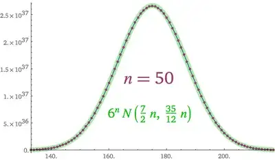

In this answer, there is a section titled "Summing Dice". It describes how convolution of the discrete function that is $1$ for each integer from $1$ through $6$, and $0$ otherwise, yields the distribution for the sum of $n$ six-sided dice.
Rolling $50$ six-sided dice will yield an approximately Normal Distribution whose mean is $\mu=50\times\frac72$ and whose variance is $50\times\frac{35}{12}$; thus, a standard deviation of $\sigma=\sqrt{50\times\frac{35}{12}}$.
