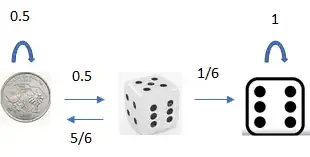

We can use Markov transition matrix to solve this problem in general. Repeating the following procedure n times to get the probability to roll 6 to exit (for example, when n = 4, the probability is shown in the last row in $S_4$ below to be $\frac{13}{72}$). $\to$
Set up the transition matrix T and initial state $S_0$, then calculate the next state with thie formula
$S_{i+1}$=T.$S_i$ (where i =0,1,2,3...).
$T= \begin{bmatrix} 0.5&\frac{5}{6}& 0 \\ 0.5&0 & 0\\0&\frac{5}{6}&1 \end{bmatrix}$ $S_0= \begin{bmatrix} 1 \\0\\0 \end{bmatrix}$
$S_1=T.S_0 = \begin{bmatrix} 0.5\\0.5\\0 \end{bmatrix}$
$S_2=T.S_1 = \begin{bmatrix} \frac{2}{3}\\\frac{1}{4}\\\frac{1}{12} \end{bmatrix}$
. $S_3=T.S_2 = \begin{bmatrix} \frac{13}{24}\\\frac{1}{3}\\\frac{1}{8} \end{bmatrix}$
$S_4=T.S_3 = \begin{bmatrix} \frac{79}{144}\\\frac{13}{48}\\\frac{13}{72} \end{bmatrix}$
