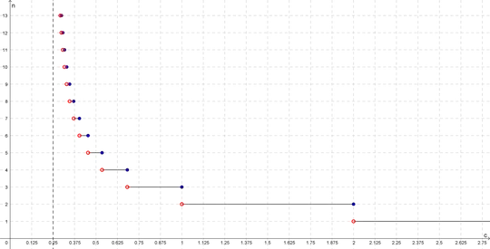

When the value of $c$ is far from the set, $z_n$ quickly escapes the bounding circle. As $c$ gets closer to the set, the number of iterations $n$ required to exceed the bounding circle grows without bound. If we look at values of $c$ on the positive real axis only and plot how many iterations it takes to exceed the bounding circle, we get a graph like this:
Graph showing how quickly the orbit of z escapes the bounding circle for real values of c greater than 0.25
If $c$ is greater than two, it only takes one iteration to escape the circle because $z_0$ is always zero and $z_1$ is always $c$. When $1 < c ≤ 2$ it takes two iterations. The next twelve transition values are approximately 0.68233, 0.5352, 0.4537, 0.4034, 0.36999, 0.34659, 0.32952, 0.31666, 0.30672, 0.29887, 0.29256, and 0.28741 — that's as far as I can get with WolframAlpha. Positive real values of $c$ less than or equal to 0.25 are part of the Mandelbrot Set and will never escape even after infinitely many iterations.

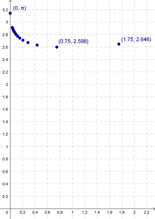

As the distance $\epsilon$ from the boundary of the set tends towards zero on the positive real axis, the number of iterations required for escape tends towards $\frac{π} {\sqrt{ϵ}}$. As $ϵ$ increases to 1.75 along the positive real axis, the relationship changes to $\frac{2\sqrt{1.75}} {\sqrt{ϵ}}$. It seems like I need some function $v(ϵ)$ such that $\frac{v(ϵ)} {\sqrt{ϵ}}$ fits my points exactly. Based on the points I have, it looks like this:
Graph showing the value that is divided by to fit the points from the previous graph.

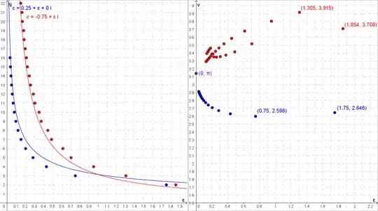

I calculated the iteration counts for $c = -0.75 + ϵ i$ and discovered that approaching the boundary of the set from this direction is more closely approximated by $\frac{π}{ϵ}$ than by $\frac{π}{\sqrt{ϵ}}$. As in the first approach, the actual iteration count starts out far from the function and approaches it as $ϵ$ goes to zero, though it wobbles around more than it does when approaching from the positive real axis. It seems my hope for a single function to calculate iteration counts may go unfulfilled.
Two graphs showing a comparison of approaching the boundary of the set from along the positive real axis, in blue, and from the positive imaginary direction towards the root of the main bulb, in red.

  • Rearranging the limit equation, I see that $\lim_{\epsilon \to 0^+} N(\epsilon) = \pi / \sqrt{\epsilon}$. This definition of $N(\epsilon)$ fits the points I have better than any of the expressions I tried previously, but it doesn't fit perfectly. As $\epsilon$ gets bigger, the expression tends towards about $2.6 / \sqrt{\epsilon}$. To make this fit, I need to find some expression $f(\epsilon)$ that equals $\pi$ when $\epsilon = 0$ and $2 \sqrt{1.75}$ when $\epsilon = 1.75$, so that $N(\epsilon)$ is exactly $v(\epsilon) / \sqrt{\epsilon}$... – Lawton Mar 12 '21 at 20:49
