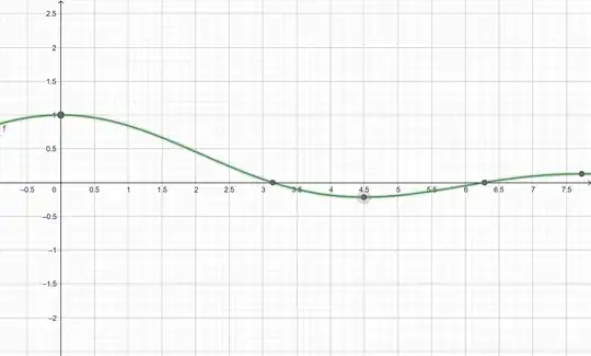

Let's find the first positive one. Where $(x_{1},y_{1}) \approx (4.5,-0.2)$
function
$$f(x) = \frac{sin(x)}{x}$$
$$\frac{d}{dx} f(x) = \frac{x \cdot cos(x) - sin(x)}{x^2}$$
$$\frac{x_{1} \cdot cos(x_{1}) - sin(x_{1})}{x_{1}^{2}} = 0$$
$$x_{1} \cdot cos(x_{1}) - sin(x_{1}) = 0$$
$$x_{1} - tan(x_{1}) = 0$$
$$x_{1} = tan(x_{1})$$
It cannot to be solved exactly.
