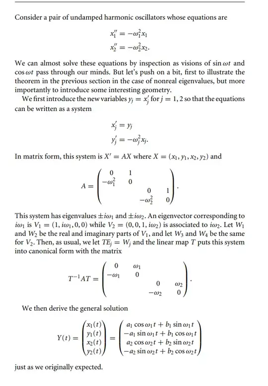

Edit: According to the book (pp.114-115):
This is pretty much the same thing so I have my solution. But how do I describe the "flow"? Is finding a solution enough?

For brevity let us focus on the example worked out in the book. One can switch from the general solution of an ODE to its flow is by determining the relationship between an anonymous initial condition and the constants $a_1,a_2,b_1,b_2$. More specifically, setting up $t=0$, if $a_1,a_2,b_1,b_2$ are the coefficients of the unique solution of the ODE with initial condition $Y_0=(y_0^1,y_0^2,y_0^3,y_0^4)\in\mathbb{R}^4$, then we have
$$ \begin{pmatrix} a_1 \\ a_2 \\ b_1 \\ b_2 \end{pmatrix}= Y(0) = Y_0 = \begin{pmatrix} y_0^1 \\ y_0^2 \\ y_0^3 \\ y_0^4 \end{pmatrix}.$$
Thus
\begin{align*} \Phi_t(Y_0) & = \begin{pmatrix} y_0^1\cos(\omega_1 t)+y_0^2 \sin(\omega_1 t) \\ -y_0^1\sin(\omega_1 t)+ y_0^2 \cos(\omega_1 t) \\ y_0^3\cos(\omega_2 t) + y_0^4\sin(\omega_2 t) \\ -y_0^3\sin(\omega_2 t) +y_0^4 \cos(\omega_2 t) \end{pmatrix}\\ &= \exp\left(\begin{pmatrix} 0 & \omega_1 & 0 & 0 \\ -\omega_1 & 0 & 0 & 0 \\ 0 & 0 & 0 & \omega_2 \\ 0 & 0 & -\omega_2 & 0 \end{pmatrix} \right) \begin{pmatrix} y_0^1 \\ y_0^2 \\ y_0^3 \\ y_0^4 \end{pmatrix}\\ &= \begin{pmatrix} \cos(\omega_1 t) & \sin(\omega_1 t) & 0 & 0 \\ -\sin(\omega_1 t) & \cos(\omega_1 t) & 0 & 0 \\ 0 & 0 & \cos(\omega_2 t) & \sin(\omega_2 t) \\ 0 & 0 & -\sin(\omega_2 t) & \cos(\omega_2 t) \end{pmatrix}\begin{pmatrix} y_0^1 \\ y_0^2 \\ y_0^3 \\ y_0^4 \end{pmatrix} \end{align*}
all give the flow $\Phi_\bullet:\mathbb{R}\to GL(4,\mathbb{R})$ of the ODE. In this case the system is completely non-hyperbolic (or elliptic), so the phase portrait considerations is subtle (as Hirsch-Smale-Devaney discuss in the book, the topological picture depends strongly on whether or not the ratio $\omega_2/\omega_1$ is a rational number. Further, each trajectory is trapped inside a $2$-torus inside $\mathbb{R}^4$.). Note that the directions of trajectories are based on the signs of $\omega_1$ and $\omega_2$. Since eigenvalues have no real part there will be no spirals.
