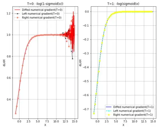

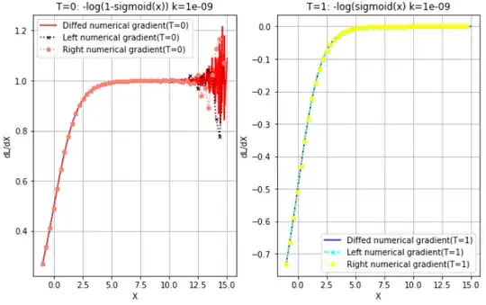

The original issue is numpy - why numerical gradient log(1-sigmoid(x)) diverges but $\log(\operatorname{sigmoid}(x))$ does not?. While trying to implement a numeric gradient (f(x+k)-f(x-k)) / 2k of the logistic log loss function, encountered a problem of float calculation gets unstable. When $f(x)$ and $k$ gets smaller such as 1e-8, $\log(\operatorname{sigmoid}(x))$ started diverging while $\log(\operatorname{sigmoid}(x))$ does not.

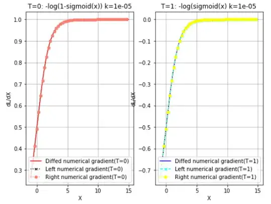

When the values are relatively large such as 1e-5, the issue does not happen, at least in the range of x.

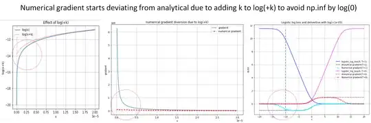

The reason trying to make k smaller is to prevent log(0) to become np.inf by adding a small number u e.g. 1e-5 but log(x+1e-5) causes a deviation of numerical gradient from the analytical one. To minimize the impact, I try to make it smallest possible and start having this issue.

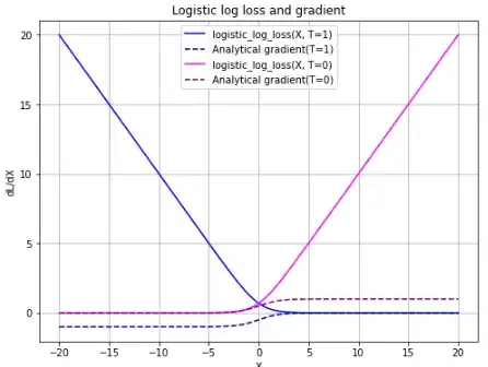

Logistic log loss and analytical gradient.
import numpy as np
import inspect
from itertools import product
import numpy as np
%matplotlib inline
def __sigmoid(X): return 1 / (1 + np.exp(-1 * X))
def __logistic_log_loss(X: np.ndarray, T: np.ndarray): return -(T * np.log(__sigmoid(X)) + (1-T) * np.log(1-__sigmoid(X)))
def __logistic_log_loss_gradient(X, T): Z = __sigmoid(X) return Z-T
N = 1000 left=-20 right=20
X = np.linspace(left,right,N) T0 = np.zeros(N) T1 = np.ones(N)
T = 1
fig, ax = plt.subplots(figsize=(8,6)) ax.plot( X, __logistic_log_loss(X, T1), color='blue', linestyle='solid', label="logistic_log_loss(X, T=1)" ) ax.plot( X, __logistic_log_loss_gradient(X, T1), color='navy', linestyle='dashed', label="Analytical gradient(T=1)" )
T = 0
ax.plot( X, __logistic_log_loss(X, T0), color='magenta', linestyle='solid', label="logistic_log_loss(X, T=0)" ) ax.plot( X, __logistic_log_loss_gradient(X, T0), color='purple', linestyle='dashed', label="Analytical gradient(T=0)" )
ax.set_xlabel("X") ax.set_ylabel("dL/dX") ax.set_title("Logistic log loss and gradient") ax.legend() ax.grid(True)

N = 1000 left=-1 right=15
Numerical gradient
k = 1e-9
X = np.linspace(left,right,N) fig, axes = plt.subplots(1, 2, figsize=(10,8))
T = 0
axes[0].plot( X, ((np.array(t_0_loss(X + k)) - np.array(t_0_loss(X - k))) / (2*k)), color='red', linestyle='solid', label="Diffed numerical gradient(T=0)" ) axes[0].plot( X[0:-1:20], ((np.array(t_0_loss(X + k)) - np.array(t_0_loss(X))) / k)[0:-1:20], color='black', linestyle='dotted', marker='x', markersize=4, label="Left numerical gradient(T=0)" ) axes[0].plot( X[0:-1:20], ((np.array(t_0_loss(X)) - np.array(t_0_loss(X - k))) / k)[0:-1:20], color='salmon', linestyle='dotted', marker='o', markersize=5, label="Right numerical gradient(T=0)" )
axes[0].set_xlabel("X") axes[0].set_ylabel("dL/dX") axes[0].set_title("T=0: -log(1-sigmoid(x))") axes[0].legend() axes[0].grid(True)
T = 1
axes[1].plot( X, ((np.array(t_1_loss(X + k)) - np.array(t_1_loss(X - k))) / (2*k)), color='blue', linestyle='solid', label="Diffed numerical gradient(T=1)" ) axes[1].plot( X[0:-1:20], ((np.array(t_1_loss(X + k)) - np.array(t_1_loss(X))) / k)[0:-1:20], color='cyan', linestyle='dashed', marker='x', markersize=5, label="Left numerical gradient(T=1)" ) axes[1].plot( X[0:-1:20], ((np.array(t_1_loss(X)) - np.array(t_1_loss(X - k))) / k)[0:-1:20], color='yellow', linestyle='dotted', marker='o', markersize=5, label="Right numerical gradient(T=1)" )
axes[1].set_xlabel("X") axes[1].set_ylabel("dL/dX") axes[1].set_title("T=1: -log(sigmoid(x)") axes[1].legend() axes[1].grid(True)

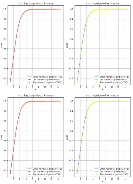

The errors have been resolved.
def t_0_loss(X):
    L = X + np.log(1 + np.exp(-X))
    return L.tolist()
def t_1_loss(X): L = np.log(1 + np.exp(-X)) return L.tolist()
%%timeit ((np.array(t_0_loss(X + k)) - np.array(t_0_loss(X - k))) / (2k)) ((np.array(t_1_loss(X + k)) - np.array(t_1_loss(X - k))) / (2k))
