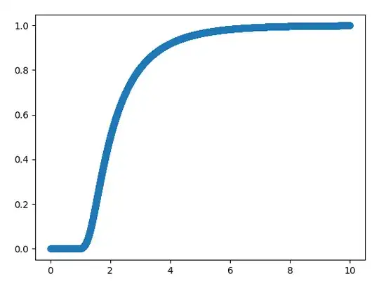

Now, of-course this is not 'that' interesting for $k \in \mathbb{Z}$ because it tends to $1$ pretty quickly, even from $k \le 9$ we are close to $1$ by a per-mille - $P(9) = 0.99799$. And so I wanted to see what happens for values $k = [0, 10]$ using the numpy library to use linspace as so:
space = np.linspace(0, 10, 100000) # This is our range
Which splits the intervals $[0,10]$ into 10K values (each are equally far away from each-other) - then calculated $P(k) ~~ \forall k \in \text{space}$ and got this beautiful output:
It look roughly like what I expected it to look like, with an asymptote $y=1$ as we tend to $1$ as $k$ grows. Meaning our function (not specifically the one in the picture) is defined as so:

The Python Code (Uses numpy and matplotlib):
import numpy as np
space = np.linspace(0, 10, 10000) Y = np.array([0]) X = space for x in X[1:]: a = 1 for i in range(2, 1000): a = (1 - 1/(i * x)) Y = np.append(Y, [a]) plt.scatter(X, Y) plt.show()
The for-loop with the range (2, 1000) tries to approximate $\prod_{i=2}^{\infty}$ (And of-course I don't have enough 'time' to wait until $\infty$.. so I chose a big enough value that would output a good approximation).
