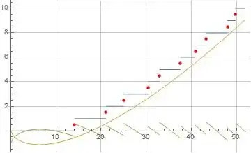

Figure (1) below illustrates $\frac{\vartheta(T)}{\pi}$ in orange, $\frac{\Im(\log\zeta(1/2+i\,T))}{\pi}$ in green, and $N_0(T)$ in blue. The red discrete dots represent the evaluation points $(\Im(\rho_k),k-1/2)$. Note $N_0(T)$ seems to evaluate exactly as desired in the range of $T$ values illustrated in Figure (1) below.
Figure (1)
Figure (1): Illustration of $\frac{\vartheta(T)}{\pi}$ (orange), $\frac{\Im(\log\zeta(1/2+i\,T))}{\pi}$ (green), and $N_0(T)$ (blue)

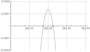

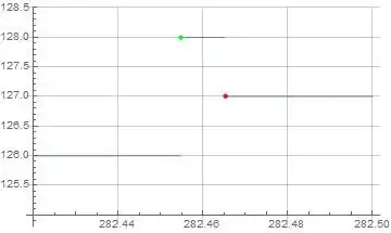

Now consider Figures (2) and (3) below which illustrate the evaluations of $\frac{\Im(\log\zeta(1/2+i\,T))}{\pi}$ and $N_0(T)$ in the neighborhood of Gram point $g_{126}$ and zeta zero $\rho_{127}$. The green dots in Figures (2) and (3) below represent the evaluations of $\frac{\Im(\log\zeta(1/2+i\,T))}{\pi}$ and $N_0(T)$ at $T=g_{126}+\epsilon$, and the red dots in Figures (2) and (3) below represent the evaluations of of $\frac{\Im(\log\zeta(1/2+i\,T))}{\pi}$ and $N_0(T)$ at $T=\Im\left(\rho_{127}\right)+\epsilon$. Note $g_{126}$ is the first Gram point where Gram's law is violated (see Wikipedia: Gram points), and the evaluation of formula (1) for $N_0(T)$ illustrated in Figure (3) below corrects itself at $T=\Im\left(\rho_{127}\right)$.
Figure (2)
Figure (2): Illustration of $\frac{\Im(\log\zeta(1/2+i\,T))}{\pi}$
Figure (3)
Figure (3): Illustration of $N_0(T)$

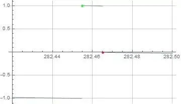

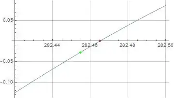

In an attempt to further clarify the source of the problem Figures (4) and (5) below illustrate the real and imaginary parts of $\zeta\left(\frac12+i\,T\right)$ in the neighborhood of Gram point $g_{126}$ and zeta zero $\rho_{127}$. The green dots in the two figures below represent the evaluation of $\zeta\left(\frac12+i\,T\right)$ at $T=g_{126}$ and the red dots in the two figures below represent the evaluation of $\zeta\left(\frac12+i\,T\right)$ at $T=\Im\left(\rho_{127}\right)$. The source of the problem is the brief positive transition of $\Im\left(\zeta\left(\frac12+i\,T\right)\right)$ at $T=g_{126}$ illustrated in Figure (5) below. This transition violates Grams's law and causes undesirable branches in $\arg\left(\zeta\left(\frac12+i\,T\right)\right)$ and $\Im(\log\zeta(1/2+i\,T))$. I'll note I believe that the built-in Mathematica functions all support analytic continuation.
Figure (4)
Figure (4): Illustration of $\Re\left(\zeta\left(\frac12+i\,T\right)\right)$
Figure (5)
Figure (5): Illustration of $\Im\left(\zeta\left(\frac12+i\,T\right)\right)$

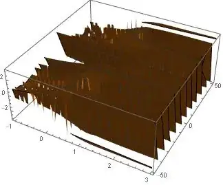

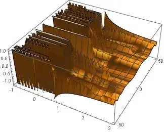

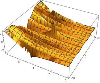

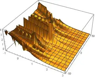

The following four figures contain 3D plots intended to clarify the Mathematica analytic continuation of $\log\zeta(s)$ in the range $\Re(s)\in (-1,3)$ and $\Im(s)\in (-50,50)$.
Figure (5)
Figure (5): 3D Plot of $|\log\zeta(s)|$
Figure (6)
Figure (6): 3D Plot of $\Re(\log\zeta(s))$
Figure (7)
Figure (7): 3D Plot of $\Im(\log\zeta(s))$
Figure (8)
Figure (8): 3D Plot of $\arg(\log\zeta(s))$

Your edit shows that Mathematica is just taking $\arg \zeta(s)$ in $(-\pi,\pi)$. The obtained function doesn't have good analytic properties, it is isn't what we need for $N(T)$ (the non-trivial zeros counting function).
What we need, the standard definition of $\arg \zeta(s)$. (ie. the one you'll find in every books and articles, except the cranks ones)
We start with $\log \zeta(s)$ analytic for $\Re(s)>1$ and $\log \zeta(2)=\ln \pi^2/6>0$ (the Dirichlet series $\sum_{p^k} \frac{p^{-sk}}{k}$), because $\zeta(s)$ has some poles and zeros, the analytic continuations to larger domains depend on which path we are doing it (rotating around $s=1$ will subtract $2i\pi$). To get a direct connexion to $N(T)$ we choose to make $\log \zeta(s)$ analytic on horizontal lines (thus on horizontal strips) not containing a zero/pole. And mathematica is doing something different, that you have to decipher.
Is it clear to you?
We choose this definition for $\log \zeta(s)$ because with $C$ a contour enclosing the zeros up to height $T$ we have by the residue theorem (the argument principle) and the symmetry around $\Re(s)=1/2,\Im(s)=0$: $$N(T)=\frac1{4i\pi}\int_C \frac{\xi'(s)}{\xi(s)}ds=\Re(\frac1{i\pi}\int_2^{2+iT}+ \int_{2+iT}^{1/2+iT} \frac{\xi'(s)}{\xi(s)}ds)$$ the RHS is $=\frac1{\pi}\Im \log \xi(1/2+iT)$ under the above analytic continuation scheme. Then $\frac1\pi\Im \log \xi(1/2+iT)$ decomposes as $1+\vartheta(T)/\pi+\frac1\pi\Im \log \zeta(1/2+iT)$
The asymptotic of $\vartheta(T)/\pi$ is found from Stirling (it is $\sim \frac{T}{2\pi} \log T$), and from Jensen's formula we get that $\frac1\pi\Im \log \zeta(1/2+iT)=O(\log T)$.
