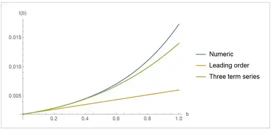

For small $b$ we may expand $e^{bx}$ and integrate term by term. It's useful to note
$$ \frac{e^{bx}}{x}= \sum\limits_{n=0}^\infty \frac{b^n x^{n-1}}{n!} $$
$$ \int\limits_c^\infty dx \ e^{-x^2} x^n =\frac{1}{2} \Gamma \left( \frac{n+1}{2} ,c^2 \right) $$
Where $\Gamma$ is the incomplete gamma function. Thus all the coefficients in the series are known!
$$ I(b)=\frac{1}{2} \sum\limits_{n=0}^\infty \frac{b^n}{n!} \Gamma(n/2,c^2) $$
This series is an exact representation of your integral. We may truncate the series to find an approximation as $b\to 0$. Here is a plot:

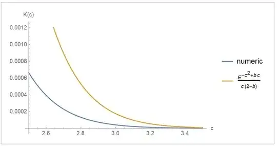

For large $c$, integrate by parts
$$ K(c) = \int\limits_c^\infty \frac{dx}{x} e^{-x^2+bx}= \int\limits_c^\infty dx \ \frac{e^{-x^2}}{bx} \frac{d}{dx} \left( e^{bx} \right) \\ $$
$$ K(c)=\frac{e^{-x^2 +bx}}{bc} \bigg\vert_c^\infty +\frac{2}{b} \int\limits_c^\infty \frac{dx}{x} e^{-x^2+bx} + \frac{1}{b} \int\limits_c^\infty \frac{dx}{x^3} e^{-x^2+bx} $$
The second term on the right is $K(c)$. For fixed $b$ and large $c$, the third term differs from $K(c)$ by at least $1/c^2$, so we have
$$ K(c)>>\frac{1}{b} \int\limits_c^\infty \frac{dx}{x^3} e^{-x^2+bx} \ \ , \ \ c \to \infty $$
Neglecting this term, solving for $K$, and simplifying, we find
$$ K(c) \sim \frac{e^{-c^2+bc}}{c(2-b)} \ \ , \ \ c \to \infty $$
Here is a plot:

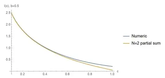

Finally for $c\to 0$, the best way I've come up with is to use the series representation, split off the $n=0$ term, then use the identities to write
$$ I(c) \sim -\frac{1}{2} \operatorname{Ei}(-c^2) + \sum\limits_{n=1}^N \left[ \frac{b^n \Gamma(n/2)}{2 \cdot n!} -\frac{b^n c^n}{n!n} \right] \ \ , \ \ c\to 0 \text{ and } N \to \infty $$
Where $\operatorname{Ei}$ is the exponential integral, and we have the 'complete' gamma function $\Gamma$. At leading order we have
$$ I(c) \sim -\frac{1}{2} \operatorname{Ei}(-c^2) + b \left( \frac{\sqrt{\pi}}{2}-c \right) \ \ , \ \ c\to 0 \text{ and } b \to 0 $$
Here is a plot:
