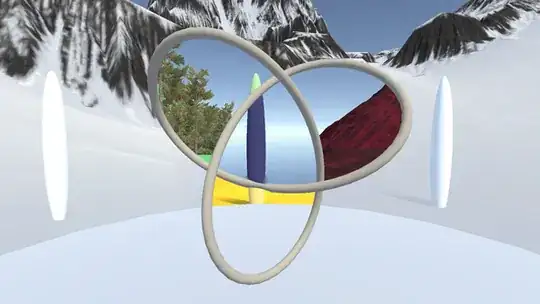

The order-2 cyclic branched cover over a trefoil has degree 6, meaning the preimage of any point off the trefoil has cardinality six. (You can find a wonderful video of this here, made by Moritz Sümmermann.) The order-3 cyclic branched cover over a trefoil has degree 24.
What is the formula for the degree of an order-$n$ cyclic branched cover over a trefoil?
(I'm unsure of the proper terminology for this.)
I'm pretty sure this is $|G_n|$, where $$G_n=\langle x,y\mid xyx=yxy,~x^n=y^n=1\rangle;$$ however, I have no idea how to find the size of this group.
Sümmermann's KnotPortal program imagines a trefoil-shaped portal connecting six worlds.

    The video comes from M. Sümmermann's project KnotPortal, which you can learn more about here: https://imaginary.org/program/knotportal, read more about here: https://link.springer.com/article/10.1007/s00283-020-10028-8, and watch more about here: https://www.youtube.com/channel/UCoUBUB-3HbaZzzb1m6Pq0Rg/videos. – Akiva Weinberger Feb 18 '21 at 16:54
