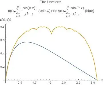

Here is a plot of the two functions $a(x)$ and $s(x)$

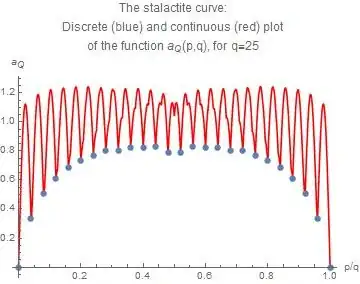

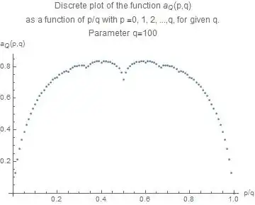

Plot
Here is a discrete plot of $a_{Q}(p,q)$
The graph is gratifying as is comes very close to the origial graph for real $x$ presented in the OP.
Notice that $a_Q$ can not serve as the general solution for real $x$. We compare the two graphs in the discussion.
Discussion
§d.1
It is interesting to compare the graphs for the function $a_Q(x\in \mathbb{Q})$ if taken at discrete values (as it is intended) and for continuous values $a_Q(x\in \mathbb{R})$. What emerges looks to me like the stalactites hanging of the ceiling of a cave
The function $a_Q(x)$ with $x\in \mathbb{R}$ creates the "ceiling", and its minima (downwards peaks) are the values at the discrete argument $x\in \mathbb{Q}$.
Notice as the main result that the function $a_{Q}(x \in \mathbb{R})$ is different from the original function $a(x)$ almost everywhere (i.e. except for a countable number of points).

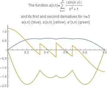

For the sake of definiteness we consider the partial sum
$$a(x,n) = \sum_{k=1}^{n} \frac{|\sin(x k)|}{(1+k^2)}$$
For fixed $n$ this is a continuous function of $x$.
The first and second derivatives are calculated from the corresponding expression for $|\sin(k x)|$, i.e.
$$\frac{d}{dx} |\sin(k x)| = \frac{d}{dx} \sqrt{\sin(k x)^2}=\frac{k \sin (k x) \cos (k x)}{\sqrt{\sin ^2(k x)}}\tag{d.1a}$$
$$\left(\frac{d}{dx}\right)^2 |\sin(k x)| = -k^2 \sqrt{\sin ^2(k x)}=-k^2 |\sin(k x)|\tag{d.1b}$$
The first derivative is discontinuous at the points where the sin vanishes, i.e. at $x = \pi \frac{m}{k}$, i.e. it has the value $-k$ for $x$ coming from below and $+k$ for $x$ coming from above. Hence $|\sin(k x)|$ and has a jump of size $2k$.
The second derivative of $|\sin(k x)|$ is continuous.
This reflects in the corresponding expressions for the partial sum which are show in the next picture
Summing up we find that the first derivative of $a(x)$ is discontinuous in all $x$ which are rational multiples of $\pi$. Without mentioning it, these were exactly the points for which $a$ had to be calculated in the OP. Hence the graph of $a'(x)$ is a sawtooth at any scale, probably even self-similar, we could call it a "rough" curve.
Casual question (1): what is the length of the graph of $a'(x)$?
Casual question (ii): what is the first derivative of $a(x)$ at $x=\frac{1}{e}$?
