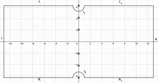

$ \newcommand{\Res}[1]{\underset{#1}{\operatorname{Res}}} $For completeness, I feel that I should post a complex solution. The exponential substitution in the question makes this problem more amenable to contour integration, because it means that we don't have to work around branch cuts.
Let $f(z)=\dfrac{z^2e^z}{e^{3z}-1}$ (yes, $z^2$ and not $z$). We'll integrate $f(z)$ around the indented rectangular contour shown below:
We'll take the limit as the left and right sides $L$ and $R$ of the rectangle move out to infinity and the indentations $I_1$ and $I_2$ shrink to zero radius. The top and bottom sides ($T_+,T_-,B_+,B_-$) will always have imaginary parts $\pm 2\pi$.
It's not too hard to see that $\int_L f(z) \, dz$ and $\int_R f(z) \, dz$ vanish in the limit. By a standard indented contour argument, we have $\int_{I_1} f(z) \, dz \to -\pi i \Res{z=2\pi i} f(z)$ and $\int_{I_2} f(z) \, dz \to -\pi i \Res{z=-2\pi i}f(z)$ (because we're going clockwise around both poles). Finally, in the limit we have
$$ \int_{T_-+T_+} f(z) \, dz \to -\textrm{p.v.}\int_{-\infty}^\infty \frac{(u+2\pi i)^2e^u}{e^{3u}-1} \, du $$
and
$$ \int_{B_-+B_+} f(z) \, dz \to \textrm{p.v.}\int_{-\infty}^\infty \frac{(u-2\pi i)^2e^u}{e^{3u}-1} \, du $$
By the residue theorem we have therefore have:
$$ \textrm{p.v.}\int_{-\infty}^\infty \left[\frac{(u-2\pi i)^2e^u}{e^{3u}-1} -\frac{(u+2\pi i)^2e^u}{e^{3u}-1}\right] \, du=\pi i \left[\Res{z=2\pi i} f(z)+\Res{z=-2\pi i} f(z)\right]+2\pi i \left[\Res{z=2\pi i/3} f(z)+\Res{z=-2\pi i/3} f(z)+\Res{z=4\pi i/3}f(z)+\Res{z=-4\pi i/3}f(z)\right] \, . $$
Canceling terms on the left-hand side gives
$$ -8 \pi i \int_{-\infty}^\infty \frac{ue^u}{e^{3u}-1} \, du=\pi i \left[\Res{z=2\pi i} f(z)+\Res{z=-2\pi i} f(z)\right]+2\pi i \left[\Res{z=2\pi i/3} f(z)+\Res{z=-2\pi i/3} f(z)+\Res{z=4\pi i/3}f(z)+\Res{z=-4\pi i/3}f(z)\right] $$
Note that this integral is legitimately convergent so we no longer need to be considering principal values. It follows that
$$ \int_{-\infty}^\infty \frac{ue^u}{e^{3u}-1}\, du=-\frac{1}{8}\left[\Res{z=2\pi i} f(z)+\Res{z=-2\pi i} f(z)\right]-\frac{1}{4} \left[\Res{z=2\pi i/3} f(z)+\Res{z=-2\pi i/3} f(z)+\Res{z=4\pi i/3}f(z)+\Res{z=-4\pi i/3}f(z)\right] \, . $$
So we just need to compute these residues! Letting $\omega=e^{2\pi i/3}$ be a primitive cube root of unity and letting $k$ be a nonzero integer (so that $f$ has a simple pole at $\dfrac{2\pi i k}{3}$), we have:
$$ \begin{align*} \Res{z=2\pi i k / 3} f(z)&=\lim_{z \to 2\pi i k / 3} \left(z-\frac{2\pi i k}{3}\right)\frac{z^2e^z}{e^{3z}-1}\\ &=\left(\frac{2\pi i k}{3}\right)^2\omega^k\lim_{z \to 2\pi i k/3} \frac{z-2 \pi i k/3}{e^{3z}-1}&&\\ &=\left(\frac{2\pi i k}{3}\right)^2\omega^k\left(\frac{1}{3}\right)&&\text{(by L'Hôpital)}\\ &=-\frac{4}{27}\pi^2 k^2 \omega^k \, . \end{align*} $$
Now, the residues in the expression for the integral can be combined in pairs symmetric about $z=0$:
\begin{align*} \Res{z=2\pi i} f(z)+\Res{z=-2\pi i}f(z)&=-\frac{4}{27}\pi^2 \cdot 9\omega^3-\frac{4}{27}\pi^2 \cdot 9\omega^3\\ &=-\frac{8}{3}\pi^2&&\text{(}\omega\text{ is a cube root of unity)}\\ \Res{z=2\pi i/3} f(z)+\Res{z=-2\pi i/3} f(z)&=-\frac{4}{27}\pi^2\omega-\frac{4}{27}\pi^2\omega^{-1}\\ &=-\frac{4}{27}\pi^2(\omega+\omega^{-1})\\ &=\frac{4}{27}\pi^2&&\text{(}\omega+\omega^{-1}=-1\text{)}\\ \Res{z=4\pi i/3} f(z)+\Res{z=-4\pi i/3} f(z)&=-\frac{4}{27}\pi^2\cdot 4\omega^2-\frac{4}{27}\pi^2\cdot 4\omega^{-2}\\ &=-\frac{16}{27}\pi^2(\omega^{-1}+\omega)&&\text{(}\omega^2=\omega^{-1}\text{)}\\ &=\frac{16}{27}\pi^2 \, . \end{align*}
Putting all this together, we have
\begin{align*} \int_{-\infty}^\infty \frac{ue^u}{e^{3u}-1} \, du &= -\frac{1}{8}\left(-\frac{8}{3}\pi^2\right)-\frac{1}{4}\left(\frac{4}{27}\pi^2\right)-\frac{1}{4}\left(\frac{16}{27}\pi^2\right)\\ &=\frac{1}{3}\pi^2-\frac{1}{27}\pi^2-\frac{4}{27}\pi^2\\ &=\frac{4}{27}\pi^2 \end{align*}
as desired.
