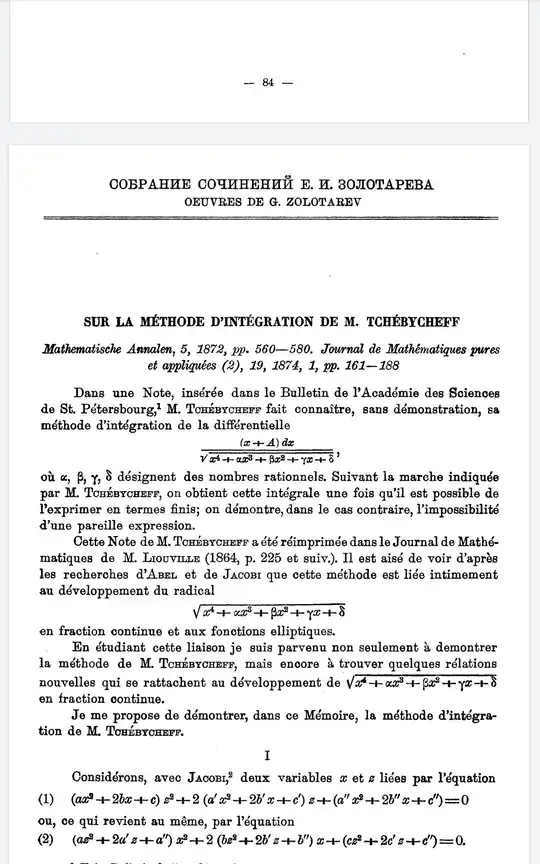

This integral was solved by Chebyshev here https://archive.org/details/117744684_001/page/n11/mode/2up
Ultimately because fractional expansion of this function in denominator has a specific form we know integral is elementary and we construct a subtitution from expansion coeff. See https://math.stackexchange.com/a/3933268/1013030
What is funny full proof for that was only given by Zolotarev. enter image description here
  • That's great, thank you. The problem here was not the proof of the existence of an analytic form when the coefficient is 71, but the proof of the impossibility of an analytic form when the coefficient is 72. These papers give the proof for this latter part. They should be referenced in the Wikipedia page, if they aren't already. – pglpm Feb 03 '22 at 11:01
    I will add them to wikipedia, fine. And yes, I did mentioned that we know WHEN (iff condition) the antidervative is elementary. – Valentin Feb 03 '22 at 13:37
    Added. BTW, https://en.wikipedia.org/wiki/Yegor_Ivanovich_Zolotarev outright talks about this integral, ha. – Valentin Feb 03 '22 at 14:00
