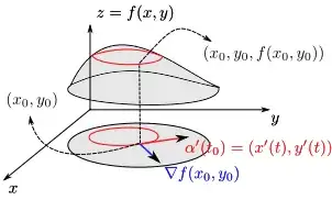

The correct statement is that the gradient vector $\nabla f(x_0,y_0)=\left(\frac{\partial}{\partial x} f(x_0,y_0),\frac{\partial}{\partial y} f(x_0,y_0) \right)$ is orthogonal to any level curve $\mathbf{\alpha(t)=(x(t),y(t))}$ of the function $\mathbf{ f} $ in point $\alpha(t_0)=(x_0,y_0)$.
That is, the gradient vector $\nabla f(x_0,y_0)=\left(\frac{\partial}{\partial x} f(x_0,y_0),\frac{\partial}{\partial y} f(x_0,y_0) \right)$ of $f$ in point $(x_0,y_0)$ is orthogonal to the tangent vector $\alpha'(t_0)=\big(x'(t_0),y'(t_0)\big)$.
Let us explain this in a more detailed way. This in fact is the statement of a theorem of calculus in several variables.
Theorem. Let $f:\Omega\subset\mathbb{R}^2\to \mathbb{R}$ be a differentiable function in a open $\Omega\subset \mathbb{R}^2$ and suppose that all partial derivatives of $f$ are continuous. Consider a curve $\alpha:I\to \mathbb{R}^2$ differentiable in interval $I=(a,b)$ and living in
$$ f^{-1}(c)=\{ (x,y)\in\Omega : f(x,y)=c\}. $$ A curve with this property is called a level curve in $c$. Suppose that the curve $\alpha(t)=(x(t),y(t))$ have coordinates $x(t)$ and $y(t)$ whose derivatives $x'(t)$ and $y'(t)$ are continuous. For all $t_0\in I$ and $\alpha(t_0)=(x_0,y_0)$, $$ \langle \nabla f(x_0,y_0), \alpha'(t_0)\rangle = \frac{\partial}{\partial x} f(x_0,y_0)\cdot x'(t_0)+\frac{\partial}{\partial y} f(x_0,y_0)\cdot y'(t_0)=0 $$
Proof. The function $(a,b)\ni t\mapsto f\circ \alpha(t)= f\big(x(t),y(t)\big)\in\mathbb{R}$ is constant equal to $c$, that is, $f\circ \alpha(t)= f\big(x(t),y(t)\big)=c$. Looking $f\circ \alpha(t)$ as a function in the variable $t$ we know that $$ \frac{d}{dt}(f\circ \alpha)(t)= \frac{d}{dt} f\big(x(t),y(t)\big)=0. $$ On the other hand, by the chain rule and gradient property we have that $$ \left.\frac{d}{dt}(f\circ \alpha)(t)\right|_{t=t_0} = \frac{\partial}{\partial \vec{v}}f(x,y) = \langle \nabla f(x_0,y_0), \vec{v}\rangle = \langle \nabla f(\alpha(t_0)), \alpha'(t_0)\rangle $$ for $\alpha'(t_0)=(x'(t_0),y'(t_0))=(v_1,v_2)=\vec{v}$. Then $$ \langle \nabla f(x_0,y_0), \alpha'(t_0)\rangle = \frac{\partial}{\partial x} f(x_0,y_0)\cdot x'(t_0)+\frac{\partial}{\partial y} f(x_0,y_0)\cdot y'(t_0)=0 $$

    Hi @Elias, how did you generate this image? Very good indeed, +1 for the complete explanation and for the image. – Gold May 25 '13 at 14:13
  • @user1620696 I generated an image but because of some bug it does not appear in my answer. The image is visible to you? – Elias Costa May 25 '13 at 14:18
  • No, it really appears, but which software you've used to generate it? – Gold May 25 '13 at 14:19
    @user1620696 I use Inkscape on Windows 7 platform. See the question in http://tex.stackexchange.com/questions/61274/is-there-any-way-to-type-latex-code-directly-into-the-text-boxes-inkscape – Elias Costa May 25 '13 at 14:21
    Shouldn't the gradient in the image be pointing towards the peak given that the gradient shows the direction of the steepest ascent? – linuxfever Dec 04 '20 at 11:09
