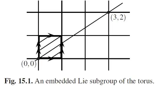

Example 15.9 (Lines with irrational slope in a torus). Let $G$ be the torus $\mathbb{R}^2/\mathbb{Z}^2$ and $L$ a line through the origin in $\mathbb{R}^2$. The torus can also be represented by the unit square with the opposite edges identified. The image $H$ of $L$ under the projection $\pi:\mathbb{R}^2\longrightarrow\mathbb{R}^2/\mathbb{Z}^2$ is a closed curve if and only if the line $L$ goes through another lattice point, say $(m,n)\in\mathbb{Z}^2$. This is the case if and only if the slope of $L$ is $n/m$, a rational number or $\infty$; then $H$ is the image of finitely many line segments on the unit square. It is a closed curve diffeomorphic to a circle and is a regular submanifold of $\mathbb{R}^2/\mathbb{Z}^2$ (Figure 15.1).
If the slope of $L$ is irrational, then its image $H$ on the torus will never close up. In this case the restriction to $L$ of the projection map, $f=\pi|_L:L\longrightarrow\mathbb{R}^2/\mathbb{Z}^2$, is a one-to-one immersion. We give $H$ the topology and manifold structure induced from $f$. Fig. 15.1. An embedded Lie subgroup of the torus.
