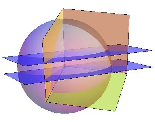

I don't care to make the calculation for you, but I think(?) this is the region you intend:
Sphere sector

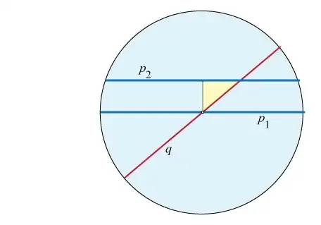

Addendum. Here is an idea to avoid computing a complex integral. Let me assume that the slice "fits" in one octant, as I drew above (as opposed, e.g., to exiting through the bottom of the octant). First, imagine that you wanted, not the area in an octant, but the area in a halfspace, demarcated by one of the coordinate planes. Then, from a side view, we have this:
Sphere slice
Your two planes are $p_1$ and $p_2$, with $p_1$ through the sphere center. The halfspace boundary is coordinate plane $q$. Now note that the difference between the half of the $2 \pi h$ area of the slice and the truncated area is just the area of two spherical triangles (one illustrated, one in back), whose angles are all known.
So I believe the area in your octant differs from a quarter of $2 \pi h$ by two spherical triangles, one at either end of the octant. The dimensions of both triangles are known from the orientation of the planes $p_1$ and $p_2$.
  • This figure is awesome. The area between two planes is exactly what I'm trying to calculate. Hope somebody can point me to the right direction for finding the solution. – mohak May 20 '11 at 00:34
  • @Joseph O'Rourke: Sweet figure ; how did you generate it? CAD? – Jacob May 20 '11 at 20:17
    @user11128: Do you want us to insert this picture in your question? – Américo Tavares May 20 '11 at 22:40
    @Jacob: Thanks! Mathematica. – Joseph O'Rourke May 21 '11 at 00:10
  • @Américo, yes please. – mohak May 21 '11 at 05:56

  • @Joseph O'Rourke, so you have mentioned that the angles of the spherical triangle shown in the picture is known, I understand the other two angles (one is $\pi/2$ and the other one is $\pi/2$ minus the angle between p1 and q) but I'm not sure about the angle between p2 and q on the sphere. – mohak May 24 '11 at 02:03
  • @11128: Let $q$ and $p_2$ intersect at point $x$. Compute a vector $v_2$ that is tangent to the sphere at $x$ and lies in plane $p_2$. $v_2$ is orthogonal to the segment from $x$ to the center of the $p_2$ circle. Compute a vector $w$ tangent to the sphere at $x$ and lying in the plane $q$. $w$ is orthogonal to the segment from $x$ to the center of the sphere. Then the angle is determined by $v_2 \cdot w$. – Joseph O'Rourke May 24 '11 at 14:03
  • @ Joseph O'Rourke, thanks for the tip. It seems to me that at one end of the octant we have a spherical triangle but at the other end we have a spherical quadrangle. Because the intersection of $p1$ and sphere in the octant is not a complete 1/4 of a big circle. – mohak May 25 '11 at 21:18
