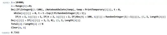

Not an answer but actually trying this I got a probability of $0.73$. The code is Mathematica Code
An explanation is as follows:
$1)$ Start at $t=0$ in the complex plain
$2)$ Add one of the following randomly $(1,-1,i,-i)$ to $t$
$3)$ Check if $t=1$ or $t=2$ (if so, stop and record this result)
$4)$ Check if the magnitude of the resulting number is greater than $100$
$5)$ If not, got back to step $2)$. If it is, then choose randomly from $t=1$ or $t=2$, record the result, and stop
I do this $10,000$ times and record the result each time. The key assumption I made was that for $|t|>100$ the probability of getting $t=1$ or $t=2$ first was about $50\%$ each.
Update: I re-ran my code with $\lambda=10^6$ and got a final probability of $P=0.726992$. This agrees heavily with the conjectured answer of $2-\frac{4}{\pi}$ as
$$\left|2-\frac{4}{\pi}-\frac{726992}{10^6}\right|<10^{-3}$$
