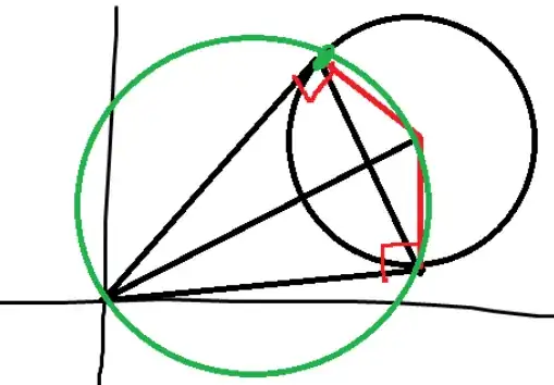

Expansion on Math777's answer, see here first, the rest of the answer's idea can be understood in the following way:
Reference picture:
Fact: From any external point there exists two tangents to the circle, therefore there must be two tangents from the point $(0,0)$ to our circle since this point is external to our circle.
Now, the vector from origin to point of contact of tangent is perpendicular to radius vector because tangent and radius are perpendicular, there are two such points like this. These two points satisfy equation of the bigger diametric circle, hence these two points are the intersection of big diameteric circle and original one (See the linked post to understand the diameteric circle idea)

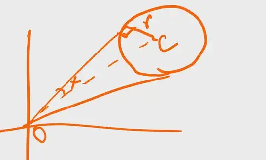

A much more sane and simpler way:
Observe the right triangle created by the line segment from origin to center, and origin to the point which is tangent to circle. Since, tangent and radius are perpendicular, we can apply good ol' trignometery easily:
$$ \sin \theta = \frac{r}{OC}= \frac{5}{10}= \frac{1}{2}$$
Hence, the $ x= \frac{\pi}{6}$ , which makes total angle between tangent as $ x = \frac{\pi}{3}$
