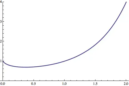

Well, an important first step is to convince them that their argument is, in fact, wrong. A simple appeal to the geometric meaning of the derivative can be very useful in this regard. Not only does this provide a very clear and easy to understand demonstration of the incorrectness of their result but it also encourages them to think about the derivative in more than one way. All too often students at this level think purely algebraically, without serious geometric consideration.
So start with a simple plot of the graph of $x^x$, which any reasonable mathematical software should be able to provide:
Now, the graph lies completely above the $x$-axis, so the function value is always positive. The slope of the graph is clearly negative, however, just to the right of the $y$-axis. Thus, there is no way that this function can be its own derivative.
Mark McClure
  • 31,496
    I like graphical explanations, but this doesn't explain why the calculation they did was wrong, it explains how they could know that there was some reason why it was. The calculation is more important than the answer. – not all wrong May 24 '13 at 16:27
    @Sharkos You are simply wrong. I've gone through this exact type of scenario many times and I've seen the look of understanding germinate as a student realizes that there is definitively an error in their argument. If you find yourself teaching mathematics some day, I promise you will need to encourage your students to think about things from multiple angles. The connection between geometry and symbols is mathematics. – Mark McClure May 24 '13 at 16:36
    I think your edit clarified the matter somewhat. I agree that being able to see the error is important, but I stand by my two observations that (i) your answer doesn't achieve the goal of seeing what it was that they did wrong (ii) in mathematical contexts it's more important to get the methods correct than the symbolic answer, more so in pedagogical contexts. I'm not sure which of these two observations is "simply wrong", but I didn't dispute any of the other things you say in your comment (indeed I agree with them all). – not all wrong May 24 '13 at 17:43
  • @Sharkos Thank you for your response. By "wrong" I was referring to "the calculation is more important than the answer." First, there is no "answer"; explanation is the whole point. Second, "calculation" seems to trivialize the geometric viewpoint. My entire point is that the interface between geometry and calculation is probably the most important thing that should be emphasized at this level. – Mark McClure May 24 '13 at 18:01
    Hang on, what? I didn't downvote! Please don't bandy about accusations or make assumptions like that without knowing! Further, I believe we have uncovered the root of the disagreement: I am not talking about your answer, but the student's answer. It's more important that the student comes away knowing a correct method than a correct answer. Their understanding of the method can be geometrical (I again refer you to my original comment where I say I like such arguments) or otherwise, that's not the issue. – not all wrong May 24 '13 at 18:37
  • Thanks for your answer Mark. I agree that it's important to convince someone that they really are wrong, your suggestion would probably be very effective done in class with a computer and a projector. – Matthew Towers May 25 '13 at 13:09
