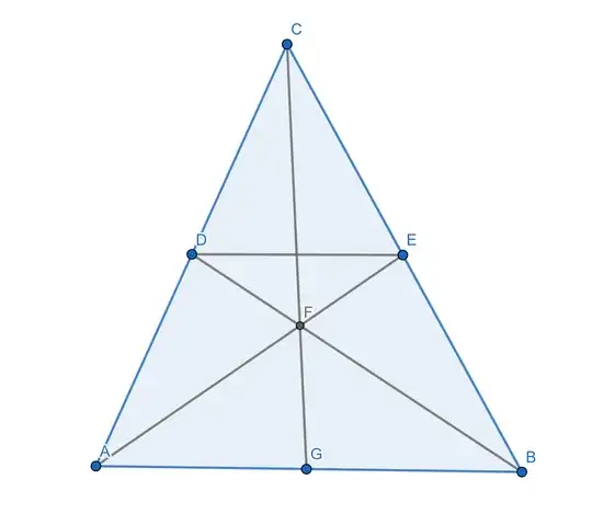

In the following triangle, AB is parallel to DE. F is an intersection point of the segments BD, AE and CG. Is it true that AG = GB?

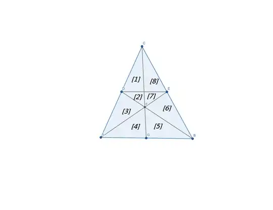

We can play withit using areas. The respective regions are labelled as shown.
(1) + (2) = (3) = (6) = (8)+ (7)
∴ (1) + (2) + (3) = (6) + (8)+ (7) = x, say
$\dfrac {x + (4)}{x +(5)} = \dfrac {(4)}{(5)}$
This gives (4) = (5) and the required result follows

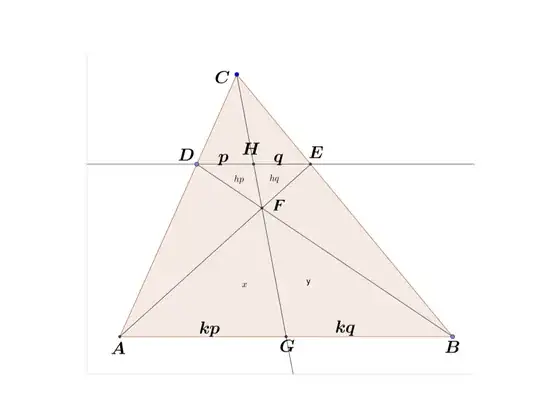

Let C(F)G cut DE at H. Suppose that DH : HE = p : q.
Then, (1) by similar triangles, AG = kp and GB = kq for some non-zero constant k; (2) by triangles with the same altitude, [FDH] = hp and [FEH] = hq for some non-zero constant h.
Let [AFG] = x and [BFG] = y. Then, by considering areas of similar objects, $x = hq \times (\dfrac {kp}{q})^2$ and $y = hp \times (\dfrac {kq}{p})^2$.
Therefore, $\dfrac {x}{y} = … = (\dfrac {p}{q})^3$
Since, by considering area of triangles with the same altitude, $\dfrac {x}{y} = \dfrac {kp}{kq}$
From $(\dfrac {p}{q})^3 = \dfrac {kp}{kq}$, we have $p = q$ after rejecting the negative quantities.

Yes, use Ceva Theorem: $${AG\over GB}\cdot {BE\over EC}\cdot {CD\over DA}=1$$ and Thales theorem: $${CD\over DA} = {EC\over BE} $$ and thus a conclusion.
