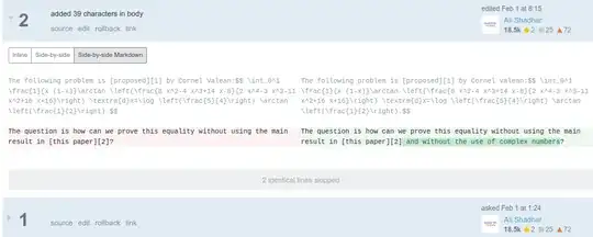

The following problem is proposed by Cornel Valean:$$\operatorname{P.V.} \int_0^1 \frac{1}{x (1-x)}\arctan \left(\frac{8 x^2-4 x^3+14 x-8}{2 x^4-3 x^3-11 x^2+16 x+16}\right) \textrm{d}x=\log \left(\frac{5}{4}\right) \arctan\left(\frac{1}{2}\right).$$
The question is how can we prove this equality without using the main result in this paper and without the use of complex numbers?

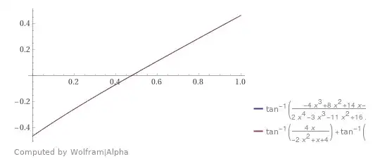

    The arctangent term splits into $\arctan\left(\frac {2}{x^2-x-4}\right)+ \arctan\left(\frac {-4x}{2x^2-x-4}\right)$. I don’t think that helps though. – Sophie Feb 04 '21 at 12:58
  • @Sophie: the problem is the second term. First one is nice: $x^2-x=-x(1-x)$ – FDP Feb 04 '21 at 13:17
