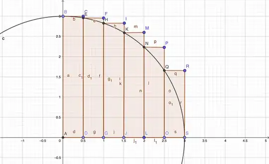

So I tried to derive the formula myself. My strategy was to fill a circle with little squares. But I couldn't figure out how to generate successively smaller squares in the right spots. So instead I decided to graph just one quadrant of the circle (since all four quadrants are identical, I can get the area of the easy +x, +y quadrant and multiply the result by 4 at the end) and put little rectangles along the curve of the circle. The more rectangles I put, the closer I get to the correct area. If you graph it out, my idea looks like this:
Approximating circle area using rectangles

    So, the idea of using more and more squares or rectangles of successively smaller and smaller sizes, that is precisely the idea of integration. That said, we can use shapes other than rectangles as well. It is common here to use triangles noting that triangles make good approximations to circular segments. A popular historical argument involves breaking the circle into segments and rearranging them in what is approximately a rectangle of height $r$ and length $\pi r$. – JMoravitz Jan 27 '21 at 21:40

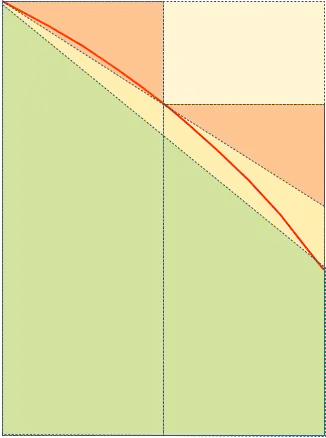

In this case if you double the number of rectangles, you approximately halve the error - this is what you would expect from treating each sub-section of the circle as a straight line section, with the excess of area having a rectangle taken out of it, leaving two triangles of the same area. Anyway, this gives you a way to get extra precision by combining successive estimates.
It's actually quite interesting to look at the difference between this extrapolated estimate and a trapezoidal approach; effectively by this picture of section of the curve:
showing that here the two-rectangles-for-one loses the upper right rectangle of area so extrapolating that forward can be thought of as losing the additional wedges off the top of the two rectangles. For comparison the green trapezoid gives an underestimate of the area under the curve, in this case.
Using your base routines for the "extrapolated area" gives the following :
