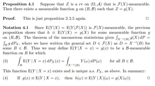

Here's a picture of the relevant section from the book. Shorack's Probability for Statisticians Notation 4.1

The measure theoretic approach to conditional probability / expectation provides a unifying framework that avoids separate argumentation for "discrete" and "continuous" random variables. One of the first examples/exercises that you will encounter is a verification that the measure theoretic $P(Y|X)$ and $E(Y|X)$ are indeed generalizations of the classical concepts. For example:
Claim: Let $X$ be a discrete random variable taking finitely many values $x_1,\ldots,x_k$, each with positive probability. Then $$E(Y\mid X)= \sum_{i=1}^k \frac{E(Y; X=x_i)}{P(X=x_i)} I(X=x_i).\tag1$$
Formula (1), which follows from the definition of conditional expectation, is an explicit representation of the measure-theoretic $E(Y\mid X)$ as a linear combination of indicators of the events $\{X=x_1\}$, $\ldots$, $\{X=x_k\}$. Another way to write (1) is: $E(Y\mid X) = g(X)$ where the function $g$ is defined by $$g(x)=\begin{cases}\displaystyle\frac{E(Y;X=x_i)}{P(X=x_i)}&\text{if $x=x_i$}\\0&\text{otherwise}\end{cases}.$$ We next remark that if we adopt the notation $$E(Y\mid X=x):=g(x),$$ then this notation coincides with the elementary concept of conditional expectation given $X=x$ for discrete $X$. You can prove that this correspondence holds in the continuous case too; this is the motivation for Notation 4.1 in the passage that you excerpted.
As another exercise, you can prove a measure-theoretic analog of (1) for $P(A\mid X)$, namely $$P(A\mid X)=\sum_{i=1}^k \displaystyle\frac{P(A; X=x_i)}{P(X=x_i)}I(X=x_i).$$ So yes, the notation $P(A\mid X=x_i)$ matches the classical notion.
In the measure-theoretic development the quantity $E(X\mid A)$, for $A$ an event, retains the same meaning as in the elementary approach: it's still $E(X;A)/P(A)$. There's no need to redefine in a "measure-theoretic way", since the numerator and denominator are well defined and their ratio makes sense as long as $P(A)$ is not zero. This is not a limitation, since typically the only events we condition on that have probability zero are those of the form $\{X=x\}$; and we've already given a rigorous interpretation to the notation $E(Y\mid X=x)$. Either that, or our arguments involve conditional expectations in their original form $E(Y\mid X)$ and we avoid conditioning on events at all.
