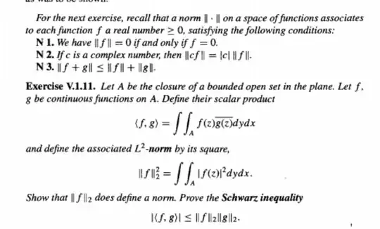

I have been following Serge Leng's Introduction to Complex Analysis at a graduate level and I feel a bit stuck on one of the exercises. The exercise in question is

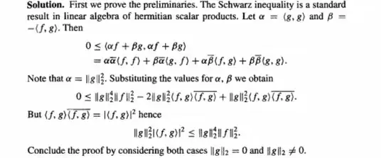

I can't seem to prove N3 without assuming the Schwarz inequality. On the other hand, I am able to prove the Schwarz inequality but I would have to assume N3.
There have been published solutions for these questions:
however, this is not the slitest bit intuitive (atleast to me). Can anybody help me/explain to me an intuitive way of looking at the problem?
