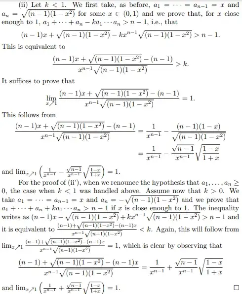

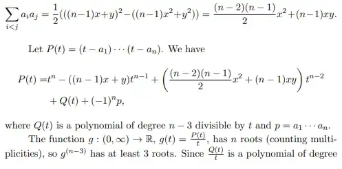

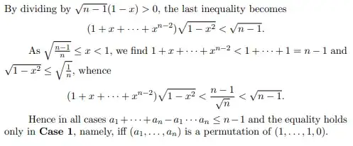

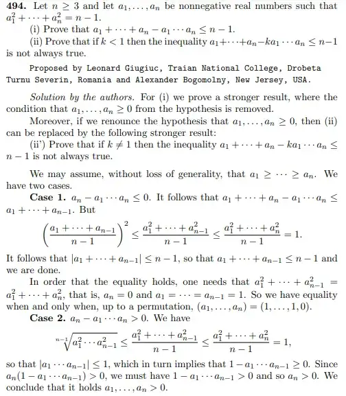

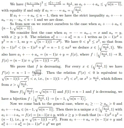

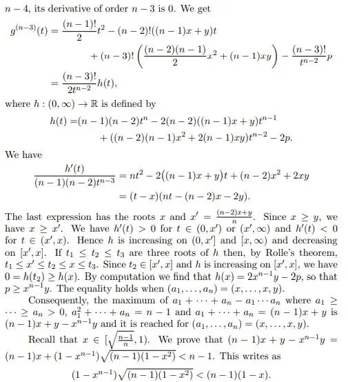

See, in the link below, our extension to n real variables (GMA Problem 494, page 57, with the our solution): https://ssmr.ro/gazeta/gma/2020/gma3-4-2020-continut.pdf
Screenshots from the link provided:
