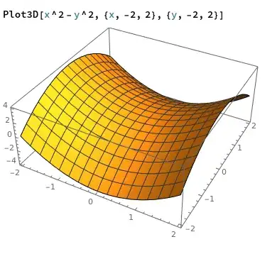

x^2-y^2 plotted for x,y in (-2,2)

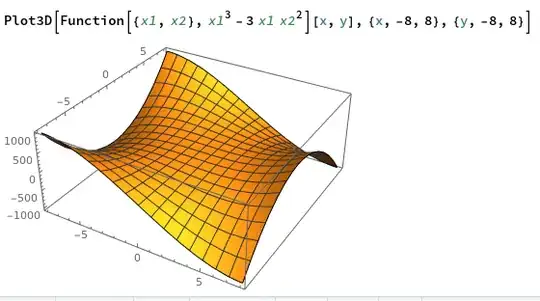

At $(0,0)$ there are two direction of descent: (0,-1) and (0,1). However the number of valley one could of descent can be larger than the number of dimensions as the the monkey saddle illustrates: monkey saddle

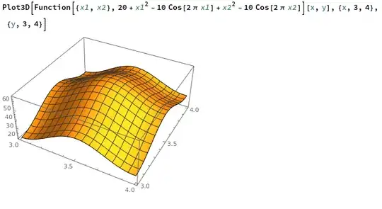

I want to distinguish descending into different valleys and from the number of directions as descent. If we look at a Unit Box of the Rastrigin function we see that the local maxima at (?.5,?.5) can descent in any direction but the axis aligned directions lead into saddle points, if we ignores those we have non connected open sets corresponding to each attractor of a "not getting stuck in saddle points" optimizers (Newton method, sufficiently perturbed gradient descent, ...). enter image description here
What is the name for the concept that would assign $(0,0)$ of the normal saddle a 2, the monkey saddle at (0,0) a 3 and any point (?.5, ?.5) a 4 on the Rastrigin function?

Any point along the x-axis of normal saddle point could be assigned a two, any point of the (strictly) positive x-axis of the monkey saddle could be assigned a 2 too. Any point of with only one component ending in .5 on the Rastrigin function would be a 2 too.
