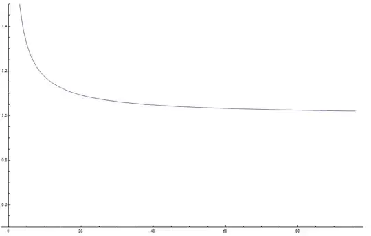

We then set $s=\frac{1}{2}$ and $\epsilon=\frac{1}{p}$ and look for symmetry by solving:
$$\frac{\zeta \left(\frac{1}{2}+\epsilon\right) \zeta (1+\epsilon)}{\zeta \left(\frac{1}{2}+\epsilon+1+\epsilon-1\right)}=\frac{\zeta (x) \zeta (x)}{\zeta (x+x-1)}$$
for $x$. Unfortunately I can only solve this numerically in Mathematica for various values of smaller and smaller epsilons, and plot the result. But we know that $x>\frac{1}{2}$ and we can set a sufficiently high upper bound for $x$. In the program I use: $\frac{1}{2} < x \leq 120$

The plot of the function $x(p)$, with $\epsilon=\frac{1}{p}$, looks like this:
plot of x as a function of p with epsilon equal to 1 divided by p
which clearly tends to $1$ as $p \rightarrow \infty$, and which would mean that we have absolute convergence for at least the second row and the second column in the now symmetric $\varphi^{-1}(\gcd(n,k))$ matrix and probably also all the other columns and rows since they are similar to alternating series like the second column and second row.
Question 1: Does the solution $$\lim_{\epsilon \to 0 } \, x(\epsilon)=1$$ tend to $1$ as the graph suggests?

    What is the definition of the function $x(p)$? – Steven Clark Jan 16 '21 at 16:05
  • It is just a quantity for the numerical solution to the equation above the program, that one gets by varying epsilon = 1/p. p goes from a small integer to infinity. – Mats Granvik Jan 16 '21 at 16:13

Can you find the asymptotic of the LHS of $\frac{\zeta \left(\frac{1}{2}+\epsilon\right) \zeta (1+\epsilon)}{\zeta \left(\frac{1}{2}+\epsilon+1+\epsilon-1\right)}=\frac{\zeta (x) \zeta (x)}{\zeta (x+x-1)}$ as $\epsilon\to 0$ ? For $\epsilon$ and the equality to hold it is immediate that $x$ must be close to $1$.
