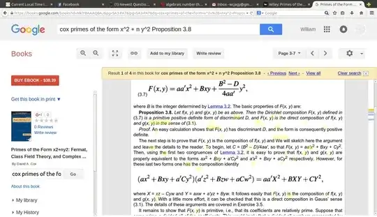

Cox treats $x^2 + 14 y^2$ in detail for the Hilbert Class Field; the outcome is pages 113-115 in the first edition, and Theorem 5.33 says a prime $p \neq 7$ is represented by $x^2 + 14 y^2$ if $(-14|p) = 1 $ and $(x^2 + 1)^2 \equiv 8 \pmod p $ has an integral solution.

The first edition of Cox has a typographical error in the description of Dirichlet composition. It is correct in the second edition:
