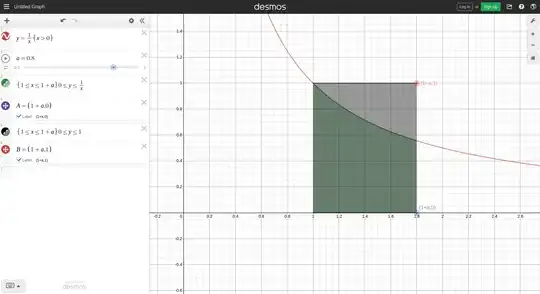

The definition of natural log in How can we come up with the definition of natural logarithm? allows a proof without words.
graph of natural log
interactive graph made from Desmos
\begin{align} \mathrm{LHS} &:= \int_1^{1+x} \frac{\mathrm{d}t}{t} = \text{area under the curve} \\ \mathrm{RHS} &= x = \text{area of the rectangle} \end{align}
The curve $y = 1/x$ is below $y = 1$ on $x \ge 1$.
Exercise: complete this proof for the case $x \in (-1,0)$.

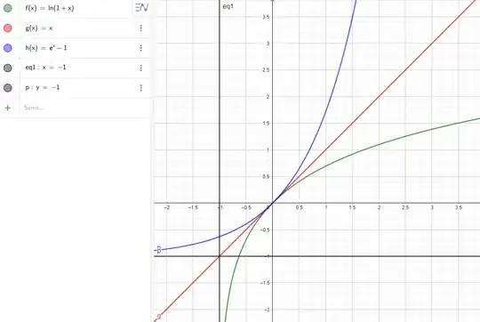

A "proof without words" :enter image description here $\forall x>-1, x\neq 0, \log(1+x)<x.$
