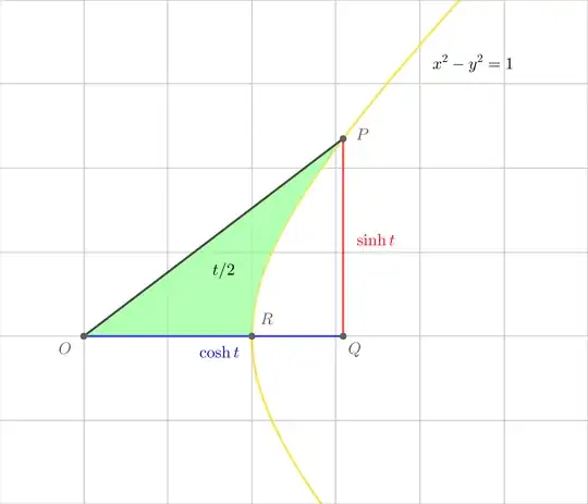

Here are a couple of calculus questions concerning hyperbolic functions:
  1. Just as $\sin$ can be defined as the unique function $f:\mathbb{R} \mapsto \mathbb{R}$ satisfying \begin{align} f''(x) &= \color{blue}{-}f(x) \\ f'(x) &= 1 \\ f(x) &= 0 \, , \end{align} $\sinh$ can be defined as the unique function $f:\mathbb{R} \mapsto \mathbb{R}$ satisfying \begin{align} f''(x) &= \color{red}{+}f(x) \\ f'(x) &= 1 \\ f(x) &= 0 \, . \end{align} Derive the exponential form of hyperbolic sine by solving the above equation.
  2. The classical way to define $\sinh$ is via the 'unit hyperbola': The geometric interpations of the hyperbolic functions If the region OPR has an area of $t/2$, then the $x$- and $y$-coordinates are, respectively, $\cosh t$ and $\sinh t$. (If you're interested in the details of how hyperbolic functions can be defined using a hyperbola, then see here.) If however you define $\sinh$ and $\cosh$ using exponentials, then it is possible to prove that the shaded area is equal to $t/2$, given that $OQ = \cosh t$ and $PQ = \sinh t$. Prove this using integration. You may need to use hyperbolic identities to simplify your answer.
  3. The graph of $\cosh$ has a curious property. For any interval $[a,b]$, the area under the graph is equal to the length of the arc connecting the points $(a,\cosh a)$ and $(b,\cosh b)$. Prove this using the formula $$ \text{arc length} = \int_{a}^{b}\sqrt{1+\left(f'(x)\right)^2} \, dx \, , $$ where $y=f(x)$ is the graph of the function in question. (Here, $f=\cosh$.) And if you're interested in seeing why the arc length formula works, then see here.
Joe
