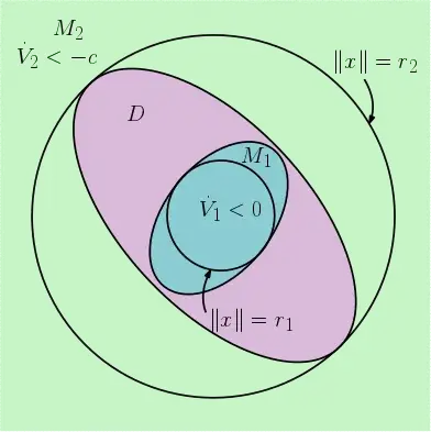

EDIT 2: After some discussion in the comments, I think the main essence of my question, is more on what happens when the Lyapunov arguments are inconclusive on this non empty set $D$ (bounded, but not containing the origin). A concrete diagram for the state space of what $r_1,r_2,M_1,M_2,D$ looks in the case I am interested is the following:

  • Note that $M_1$ in your plot should be inside the circle $|x|=r_1$, see the explanation in my answer. – Arastas Jan 13 '21 at 11:38
  • I put $|x|=r_1$ inside $M_1$ to comply with the item: $\dot{V}_1(x)<0$ $\ \forall x : |x|<r_1$ from my question. By I get your point. There is another $|x|=r_3$ which covers $M_3$ as given in your answer. But I as you were saying, maybe these circles are not as important as the sets $M_1,M_2$. – FeedbackLooper Jan 13 '21 at 11:46
