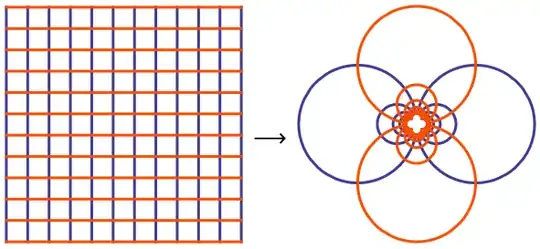

Nonetheless, there are a number of standard tricks to help us visualize the function. Perhaps the most standard is to illustrate the effect that the function has on some standard domain or set of domains. If you type "plot 1/z" into WolframAlpha, for example, you'll see a number of images related to the function, one of which is labeled "Complex map" and looks like so:

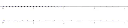

This illustrates how a grid of lines throughout the square $[-1,1]\times[-1,1]$ is affected by the map $z\rightarrow 1/z$. This is a bit like trying to understand the map $f(x)=x^2$ by examining the following picture:
The top picture represents a set of points evenly distributed throughout the interval $[0,2]$; the bottom illustrates the image of the points under $f(z)=z^2$.

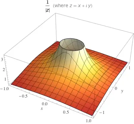

I reiterate, though, this is just one of a number of techniques for visualizing these types of functions. Other possibilities include: plotting the real and imaginary part as 3D graphs, doing the same with the magnitude and argument, or creating contour plots of these. This works because for example, writing $w=|f(x+i*y)|$, we see that $w$ is a real-valued function of the two real variables $x$ and $y$, which means we can make a 3D plot. Here's the result of the WolframAlpha query "plot |1/z|", for example:

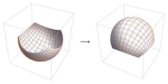

It can get really crazy if you move to the Riemann sphere. Here's WolframAlpha's "Riemann sphere map":
To really understand this, you should check out the video Möbius Transformations Revealed on YouTube!

  • Here my question comes then, I got these pictures as well, but is this 3D picture then a complex plane? I know because z=x+iy be have to have a picture in 3D of course. I am not sure what it means then plotting this punction in complex plane. Thanks by the way... – Berrier May 23 '13 at 10:35
  • The complex plane is the domain of the function. If we write $z=f(x+iy)$, then in the picture the complex plane is the horizontal plane where $z=0$. – Mark McClure May 23 '13 at 11:17

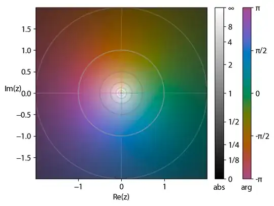

A common way of plotting complex function is to use domain coloring. In the polar form of your function values $f(z) = r \exp(i\phi)$, modulus $r$ is associated with brightness and argument $\phi$ with "hue". This taps into the visual system of the brain and helps getting a fast grasp on those otherwise hard-to-visualize functions.
With cplot, a Python package I recently wrote, it's easy to create such plots. Also check out the gallery! For your function:
import cplot
plt = cplot.plot(lambda z: 1 / z, (-2.0, 2.0, 400), (-2.0, 2.0,400)) plt.show()
