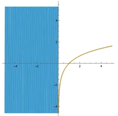

Both $f_n(x)=\psi(n x)-\psi(n)$ and $f_n(x)=\psi(n x)-\ln n$ approach $\ln x$ as $n$ goes to infinity.
You get a function whose right-hand side resembles logarithm and the left-hand side has a lot of poles.
