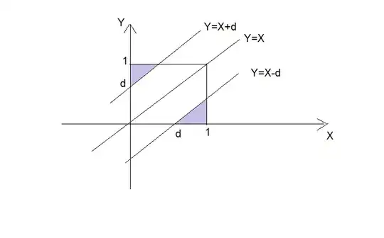

If you to a drawing of the problem it will be very easy to find
$$F_D(d)=1-(1-d)^2$$
and derivating you get the density
$$f_D(d)=2(1-d)\cdot \mathbb{1}_{[0;1]}(d)$$
The CDF is the white area, in function of $d \in [0;1]$ To calculate it, it is easier to calculate the purple area $(1-d)^2$ and take the complement to 1

What is the pink area in this unit square?
added enter image description here
Henry
  • 169,616
  • I think I get it, I should treat one of the X's as the y coordinate, draw the lines $X_2=X_1-t$ and $X_2=t-X_1$ and treat the area according to the $\geq$ or $\leq$, which then gives me the whole area of the square (1) minus the area in pink? Which then coincides with @tommik 's answer – orav94 Jan 07 '21 at 14:25
  • Yes, though the second line is $X_2=X_1+t$ – Henry Jan 07 '21 at 14:26
  • Yes my bad thank you – orav94 Jan 07 '21 at 14:27
