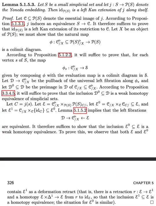

I am currently trying to understand the following proof in Higher Topos Theory.
Lemma 5.1.5.3
I am fine with almost all of the argument, except with the claim that $\mathcal{E}^1$ is a deformation retract of $\mathcal{E}$. While I feel like this is true, I am unable to prove it properly, i.e writing down a well-defined morphism of simplicial sets $r : \mathcal{E} \to \mathcal{E}^1$ along with a homotopy witnessing it as a deformation retract.

I can show that $\mathcal{E}^1 \to \mathcal{E}^0$ is a weak homotopy equivalence by viewing it as a pullback of the initial (hence left anodyne) map $\{\mathrm{id}_{\mathcal{P}(S)}\} \hookrightarrow \mathcal{P}(S)_{C/ }$ by the right fibration (hence proper map) $\mathcal{C}_{/X} \to \mathcal{C}$. I can not make this argument work for $\mathcal{E}^1 \to \mathcal{E}$, unless the map $(\mathcal{C}_{/X})^\rhd \to \mathcal{P}(S)$ is proprer. I have no idea wether this can be expected or not.
Using a similar kind of argument (pulling back the right anodyne map $\{v\} \to (\mathcal{C}_{/X})^\rhd$ along the left fibration $\mathcal{P}(S)_{C/ } \to \mathcal{P}(S)$), I can show that $\mathcal{E}^0$ indeed has the same homotopy type as $\mathcal{E}$ and that it is the homotopy type of $\mathrm{Map}_{\mathcal{P}(S)}(C, X)$ but this argument does not say that this equivalence is induced by $\mathcal{E}^0 \to \mathcal{E}$.
Is there a simple argument to show that $\mathcal{E}^1 \to \mathcal{E}$ is a weak homotopy equivalence, or even to show directly that $\mathcal{E}^0 \to \mathcal{E}$ is a weak homotopy equivalence?
Update: It seems to me that one can show directly that $\mathcal{E}^0$ is a deformation retract of $\mathcal{E}$, and that the homotopies do not use composition internal to $\mathcal{P}(S)$. However, I am not yet been able to write the homotopy either, and would appreciate any hint or construction that would help defining such a map.
