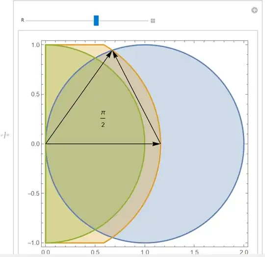

Because there is implied some complex trigonometric function algebra, use Mathematica
Manipulate[With[{},
  RegionPlot[{(x - 1)^2 + y^2 < 1 , x^2 + y^2 < R^2 ,
                     x^2 + y^2 < 1}, {x, 0, 2}, {y, -1, 1},
 Epilog -> {
 {Arrow[{{0, 0}, {R, 0}}],
  Arrow[{{0, 0}, R {R/2, Sqrt[1 - R^2/4]}} ]},
 {Arrow[{{R, 0}, R {R/2, Sqrt[1 - R^2/4]}}]}, {Text[
   Rationalize[
     NIntegrate[
      Boole[(x - 1)^2 + y^2 < 1 && x^2 + y^2 < R^2 ]/\[Pi],
        {x, 0,2}, {y, -1, 1}], 1/100] *\[Pi], {R/2, 1/4}]}}]],
  {{R, 1.16}, 0, 2}, ControlPlacement -> Top]
Goat Gazing Area

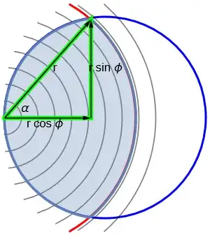

The two circles have the point of intersection at
$$(a\cos \phi - 1)^2 + a^2 (1 - \cos^2 \phi) \ = \ 1 \quad \leftarrow \quad \phi= \cos^{-1}\left(\frac{r}{2}\right)$$
Grazin Area Polar
So we have
$$\begin{align}&\text{GrazingArea}(R) \ = \ \int _0^R\int _{-\sin ^{-1}\left(\sqrt{1-\frac{r^2}{4}}\right)}^{\sin ^{-1}\left(\sqrt{1-\frac{r^2}{4}}\right)} d\phi\ \ r dr \ \\& = \ \ \frac{1}{2} R \left(\pi R-\sqrt{4-R^2}\right)-\left(R^2-2\right) \sin ^{-1}\left(\frac{R}{2}\right) \end{align}$$
The result is showing that the non grazed area is simple
$$\begin{align}&\text{NonGrazingArea}(R) \ = \ \int _R^2\int _{-\sin ^{-1}\left(\sqrt{1-\frac{r^2}{4}}\right)}^{\sin ^{-1}\left(\sqrt{1-\frac{r^2}{4}}\right)}rd\phi dr \ \ \\& = \ \ \frac{1}{2} R \sqrt{4-R^2}-\left(R^2-2\right) \cos ^{-1}\left(\frac{R}{2}\right) \end{align}$$
