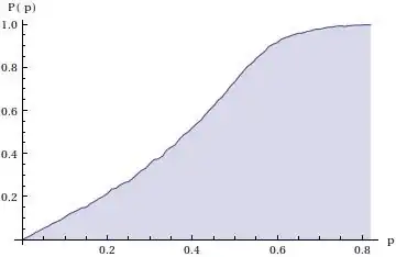

The following is an approximation of the graph of the function $p\mapsto P(p)$ for $p=0,.01,\ldots,.82$. enter image description here

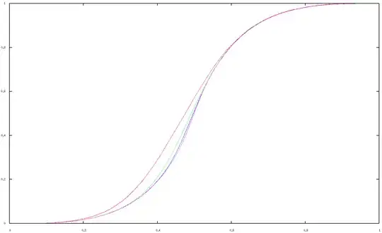

We can extend this to uncover a hidden symmetry in $P(p)$. Let $R(p)$ denote the probability that the vertices are connected by a path not including $e$; then $P(p)=p+(1-p)R(p)$. By the above duality argument, $R(p)=(P(p)-p)/(1-p)$ exhibits the symmetry $R(p)=1-R(1-p)$, which is antisymmetry about the point $R(1/2)=1/2$. Here's a plot of $R(p)$ that confirms this symmetry:
R(p) for different lattice sizes
(Right-click on the image and open in a new tab/window to see the full resolution.)
The plot was obtained using this code, which associates each edge of a finite square lattice (with periodic boundary conditions) with a threshold uniformly distributed on $[0,1]$, then adds the edges in order of increasing thresholds and updates a histogram for $P'(p)$ when adjacent sites become connected. The red, green, blue and magenta lines show calculations on lattices of dimensions $5$, $10$, $20$ and $50$, respectively. The plot seems to be nearly converged up to its graphical resolution at dimension $50$. $10000$ runs were averaged for each lattice size, and the coincidence of the results for different sizes indicates that the statistical errors are at or below the plot's graphical resolution.

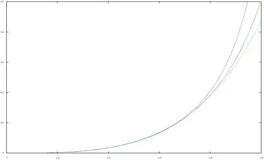

Each of the self-avoiding paths corresponds to a self-avoiding loop obtained by adding the edge $e$. The number of self-avoiding loops of length $l$ is conjectured to be asymptotic to $B\mu^ll^{-\beta}$ with $\mu\approx2.63816$ (see Analytic Combinatorics, p. 365). The initial coefficients above suggest that inclusion–exclusion doesn't affect the exponential growth rate $\mu$, so we can expect the power expansion to converge up to $p=1/\mu\approx0.379052$. This is confirmed by a comparison of the numerical results with the expansions of $R(p)$ up to $5$th order and up to $13$th order:
comparison of numerical plot with expansions up to 5th and 13th order

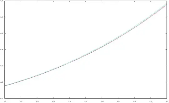

The expansion up to $5$th order (in green) is already a very good approximation up to $p\approx1/\mu$, and around and beyond $1/\mu$ the expansion up to $13$th order (in blue) is actually worse. A detailed plot of values around $p=0.25$ indicates that the higher-order terms aren't simply wrong and do improve the approximation in the interior of the interval of convergence:
detailed comparison near p=0.25
