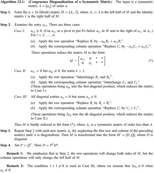

Regarding points 1) and 2), let me introduce an interesting algorithm to diagonalize a real symmetric matrix using only elementary row operations (taken from Schaum's Outline of Theory and Problems of Linear Algebra, by Lipschutz and Lipson).
Congruence Diagonalization of a Symmetric Matrix

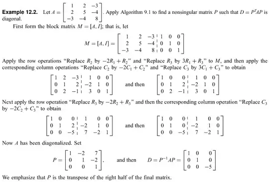

And here is a worked example of the above mentioned algorithm:
    thank you for showing me this; I think this is almost what we have been seeing recently here on MSE, and differs just in things like the transpose. Note that the final expression in Example 12.2 reads "and then $D = P^{-1}AP$" but should read "and then $D = P^TAP$" I think you should leave this here: it is quite possible that this method (or the way I wrote it at my question) is exactly what they wanted George 0X to do, and he misinterpreted. Otherwise, to orthogonally diagonalize it would need entirely numerical methods and be impossible by hand. – Will Jagy Aug 09 '15 at 23:49
