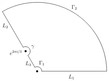

Here we discuss two ways of tackling the integral using contour integral. I added Solution 1 to help you implement the hint suggested by the professor. However, I personally recommend you to jump directly to Solution 2.
Solution 1. Consider
$$ f(z) = \frac{\log z}{z^3 - 1}, $$
where $\log(\cdot)$ is the principal complex logarithm. Now we integrate $f$ along the boundary of the indented sector of opening $2\pi/3$:
Contour
Here, the radius of the larger arc $\Gamma_2$ (resp. smaller arc $\Gamma_1$) is $R$ (resp. $\epsilon$) and $0 < \epsilon < 1 < R$. Then it is easy to check that

for $C = 2\pi/3$, and so, the integrals along these curves vanish as $\epsilon \to 0^+$ and $R \to \infty$. So by the residue theorem,
\begin{align*} \int_{L_1} f(z) \, \mathrm{d}z + \int_{L_2} f(z) \, \mathrm{d}z + \int_{L_3} f(z) \, \mathrm{d}z + \int_{\gamma} f(z) \, \mathrm{d}z = o(1) \end{align*}
as $\epsilon \to 0^+$ and $R\to\infty$. However, using the fact that $\omega = e^{2\pi i/3}$ is a simple pole of $f(z)$, the function $(z - \omega)f(z)$ is analytic at $z = \omega$. So
\begin{align*} \lim_{\epsilon \to 0^+} \int_{\gamma} f(z) \, \mathrm{d}z &= \lim_{\epsilon \to 0^+} i\int_{2\pi/3}^{-\pi/3} \epsilon e^{i\theta} f(\omega + \epsilon e^{i\theta}) \, \mathrm{d}\theta \tag{$z=\omega+\epsilon e^{i\theta}$} \\ &= -i \pi \lim_{z \to \omega} (z - \omega)f(z) = -i \pi \mathop{\mathrm{Res}}_{z = \omega} f(z) \\ &= \frac{2\pi^2}{9} \omega. \end{align*}
