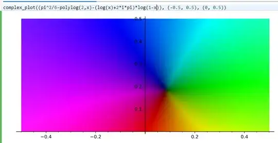

Next $\text{Li}_2'(z)=\frac{-\log(1-z)}{z}$ shows that $$\text{Li}_2(1-z)=\frac{\pi^2}{6}-\text{Li}_2(z)-\log(z)\log(1-z)$$ for $z\in (0,1)$ and it is meant the principal branch of each term.
Continuing analytically by starting at $1/2$ and rotating one time around $z=0$ we get a new branch
$$\text{Li}_2(1-z)^{new\ branch}=\frac{\pi^2}{6}-\text{Li}_2(z)-(\log(z)+2i\pi)\log(1-z)$$ analytic for $\Im(z)>0,|z|<1$.
This branch has a zero near $0.08+0.18 i$, and since $\text{Li}_2(0)=0$ too it means that $\text{Li}_2^{-1}$ is multivalued, ie. there are some curves $\Gamma:0\to 0$ along which $\text{Li}_2^{-1}$ is analytic but not the same at its departure and arrival.
(it is the argument principle which proves that there is a zero on this plot)

  • The argument principle requires a continuous curve, not a sequence of hundreds of points/pixels. :) Of course we can get around this by appealing to continuity... – mr_e_man Dec 08 '20 at 03:08
