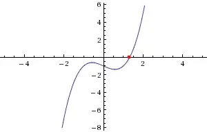

Part 3
Correct. We could have also plotted the function to see:
