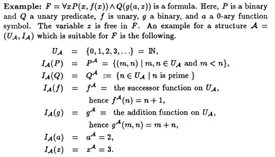

Here $\mathcal{A}$ is a structure and $P^{\mathcal{A}} = I_{\mathcal{A}(P)}$ is described as below: Predicate logic structure pair
I think I kinda get what structure is about, my problem is about the first picture. I didn't get what does it mean. Does it mean that if we had a predicate symbol, the value of that predicate symbol is true if all its terms are defined by that structure? If so then if for example we have $P^2(x,f(x))$ and both $x$ and $f(x)$ are defined then $P$ is true regardless? That doesn't seem right!

Take the example on p. 45, and restrict yourself subformula $Q(g(a,z))$ for the moment:
By a stepwise evaluation recursing down the definitions of $\A(\Box)$, we get that
$ \A(Q(g(a,z)) = 1\\ \Leftrightarrow \underbrace{(\A(g(a,z))) \in Q^\A}_{\text{def. } \A(P(t_1, \ldots, t_k))}\\ \Leftrightarrow \underbrace{g^\A(\A(a), \A(z))}_{\text{def. } \A(f(t_1, \ldots, t_k))} \in Q^\A\\ \Leftrightarrow g^\A(\underbrace{a^\A}_{\text{def. } \A(f(t_1, \ldots, t_k))}, \underbrace{z^\A}_{\text{def. } \A(x)}) \in Q^\A\\ \Leftrightarrow \underbrace{+}_{\text{def. } I_\A(g)} (\underbrace{2}_{\text{def. } I_\A(a)}, \underbrace{3}_{\text{def. } I_\A(z)}) \in \underbrace{\{n \in U_\A : n \text{ is prime }\}}_{\text{def. } I_\A(Q)}\\ \Leftrightarrow \underbrace{5}_{\text{def. } + } \in \{n \in \underbrace{\mathbb{N}}_{\text{def. } U_\A} : n \text{ is prime }\}\\ \text{Since 5 is prime, } \A(Q(g(a,z)) = 1. $
