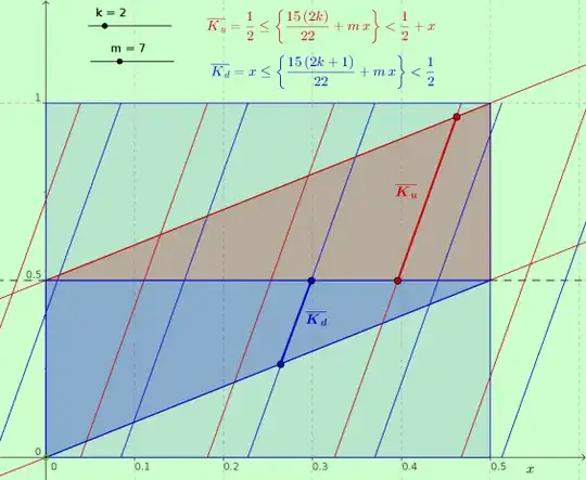

$\overline K (k,x)dx $ is represented by the segments of the two sawtooth waves intercepted
inside the respective forbidden areas like those shown in the following sketch. lanc_orol_2
Note that for better clarity the inclination $m$ of the lines is much lower than $719/11$.
The integral translate into the sum of the $\Delta x$ of each segment.
To compute them let's start with computing the intercepts with $y=1/2$.
The minimum intercept $s_{\,0}$ will be $$ \eqalign{ & y = \left\{ {q + m\,x} \right\} = \left\{ {\left\{ q \right\} + m\,x} \right\} = {1 \over 2}\quad \Rightarrow \cr & \Rightarrow \quad \left\{ q \right\} + m\,x = n + {1 \over 2}\quad \Rightarrow \cr & \Rightarrow \quad m\,x = n - \left( {\left\{ q \right\} - {1 \over 2}} \right) \cr & \Rightarrow \quad m \, s_{\,0} = \left\lceil {\left\{ q \right\} - {1 \over 2}} \right\rceil - \left( {\left\{ q \right\} - {1 \over 2}} \right) = \left( {{1 \over 2} - \left\{ q \right\}} \right) - \left\lfloor {{1 \over 2} - \left\{ q \right\}} \right\rfloor = \cr & = \left\{ {{1 \over 2} - q} \right\} \cr} $$ For the lower triangle we can simply replace $q$ with the negative of the intercept with $x=1/2$ , i.e.: $$ m\,s_{\,0} = \left\{ {{1 \over 2} + {m \over 2} + q} \right\} $$

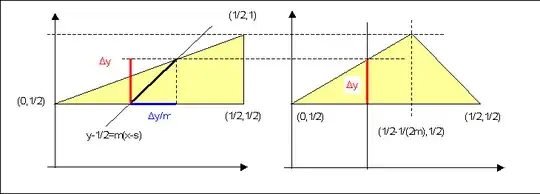

Next we take the upper triangle and slant it as shown lanc_orol_3
where $$ \Delta y(x) = \left\{ {\matrix{ {{m \over {m - 1}}x} & {\left| {\;0 \le x < {1 \over 2}\left( {1 - {1 \over m}} \right)} \right.} \cr {m\left( {{1 \over 2} - x} \right)} & {\left| {\;{1 \over 2}\left( {1 - {1 \over m}} \right) \le x < {1 \over 2}} \right.} \cr } } \right. $$ so that we will compute $\Delta x$ as $ 1/m \, \Delta y$.
Finally, we are sampling the slanted triangle at points starting from $s_{\, 0}$ (which depends on $q$ and thus on $k$) and progressing with $\Delta s = 1/m$. $$ s(k,j) = s_{\,0} + {j \over m} = \left\{ {\matrix{ \matrix{ {1 \over m}\left\{ {{1 \over 2} - q} \right\} + {j \over m} = {{11} \over {719}}\left( {\left\{ {{1 \over 2} - {{15\left( {2k} \right)} \over {22}}} \right\} + j} \right) = \hfill \cr = {{11} \over {719}}\left( {\left\{ {{{11 - 8k} \over {22}}} \right\} + j} \right) = s_{\,u} (k,j) \hfill \cr} \hfill & {{\rm upper}\;{\rm Tr}{\rm .}} \hfill \cr \matrix{ {1 \over m}\left\{ {{1 \over 2} + {m \over 2} + q} \right\} + {j \over m} = {{11} \over {719}}\left( {\left\{ {{1 \over 2} + {{719} \over {22}} + {{15\left( {2k + 1} \right)} \over {22}}} \right\} + j} \right) = \hfill \cr = {{11} \over {719}}\left( {\left\{ {{{19 + 8k} \over {22}}} \right\} + j} \right) = s_{\,d} (k,j) \hfill \cr} \hfill & {{\rm lower}\;{\rm Tr}{\rm .}} \hfill \cr } } \right. $$
Since $$ \eqalign{ & {{11} \over {719}}\left( {\left\{ {{{11 - 8k} \over {22}}} \right\} + j} \right) = {1 \over {2 \cdot 719}}\left( {22\left\{ {{{11 + 14k} \over {22}}} \right\} + 22j} \right) \cr & 22\left\{ {{{11 + 14k} \over {22}}} \right\}\quad \Rightarrow \quad 11 + 14k = 2n + 1\quad \left( {\bmod 22} \right)\quad \Rightarrow \cr & \Rightarrow \quad 5 + 7k = n\quad \left( {\bmod 11} \right)\quad \Rightarrow \quad 7k \equiv n + 5\quad \left( {\bmod 11} \right) \cr} $$
and $$ \eqalign{ & {{11} \over {719}}\left( {\left\{ {{{19 + 8k} \over {22}}} \right\} + j} \right) = {1 \over {2 \cdot 719}}\left( {22\left\{ {{{19 + 8k} \over {22}}} \right\} + 22j} \right) \cr & 22\left\{ {{{19 + 8k} \over {22}}} \right\}\quad \Rightarrow \quad 19 + 8k = 2n + 1\quad \left( {\bmod 22} \right)\quad \Rightarrow \cr & \Rightarrow \quad 9 + 4k = n\quad \left( {\bmod 11} \right)\quad \Rightarrow \quad 4k \equiv n + 2\quad \left( {\bmod 11} \right) \cr} $$
then the {Independent Residues theorem](https://en.wikipedia.org/wiki/Residue_number_system)
assures us that the the two relations above are bijections between
$$\left[ {0 \le k \le 10} \right] \Leftrightarrow \left[ {0 \le n \le 10} \right]$$
We have that the set of the sampling points are the same for both the triangles, and we can simply put
$$ \left\{ \matrix{ s_u (n) = s_d (n) = {{2n + 1} \over {2 \cdot 719}} \hfill \cr 0 \le s(n) < {1 \over 2}\left( {1 - {1 \over m}} \right) = {1 \over 2}\left( {{{708} \over {719}}} \right)\quad \Rightarrow \quad 0 \le n \le 353 \hfill \cr {1 \over 2}\left( {1 - {1 \over m}} \right) \le s(n) < {1 \over 2}\quad \Rightarrow \quad 354 \le 2n \le 358 \hfill \cr} \right. $$
And finally obtain
$$ \eqalign{ & \overline P = {1 \over {11}}\sum\limits_s {\Delta x(s)} = {1 \over {11m}}\sum\limits_s {\Delta y(s)} = {2 \over {11m}}\sum\limits_{\,0 \le n \le 358} {\Delta y(s_u (n))} = \cr & = 2\left( {{1 \over {708}}\sum\limits_{\,0 \le n \le 353} {{{2n + 1} \over {2 \cdot 719}}} + {1 \over {11}}\sum\limits_{\,354 \le n \le 358} {\left( {{1 \over 2} - {{2n + 1} \over {2 \cdot 719}}} \right)} } \right) = \cr & = {1 \over {719}}\left( {{1 \over {708}}\sum\limits_{\,0 \le n \le 353} {\left( {2n + 1} \right)} + {1 \over {11}}\sum\limits_{\,354 \le n \le 358} {\left( {718 - 2n} \right)} } \right) = \cr & = {1 \over {719}}\left( {{{354 + 354 \cdot 353} \over {708}} + {{5 \cdot 718 - 2 \cdot 5 \cdot 356} \over {11}}} \right) = \cr & = {1 \over {719}}\left( {{{354} \over 2} + {{30} \over {11}}} \right) = {{1977} \over {7909}} = {1 \over 4}\left( {1 - {1 \over {7909}}} \right) \cr} $$
