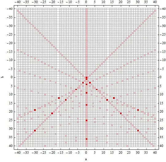

You might enjoy this representation of solutions for small $b$s and $a$s.
grid of integer solutions of $x^3 - b x + a =0$
with red squares indicating combinations of $b$ and $a$ where the polynomial has 3 integer solutions and pink squares where there is only one (in this case the polynomial can be factorized with an integer linear factor, the two other solutions being complex conjugates). You can guess with this image (but need to prove) that there is no solution for negative b, that the solutions are symmetric around the vertical axis and that solutions arise as intersections of straight lines representing one parameter families of equations with at least one integer root.
