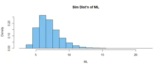

If I repeat this procdure many times, I can get a good idea of the distribution of the length ML of longest run among 100 tosses, and thus of its mean. The answer is $7.975 \pm 0.011.$ With $m = 10^5$ iterations one can expect about two place accuracy. (With $m = 10^6$ I got $6.978\pm 0.004.)$

hist(ML, prob=T, br=(2:22)+.5, col="skyblue2", main="Sim Dist'n of ML")

  • Thank you so much for the response @BruceET ! I guess I didn't word my question properly (not an English native speaker). My real question is "What is the probability of at least a 6-streak (doesn't matter whether it's HHHHHH or TTTTTT) appearing in a 100 coin tosses? Assume the experiment is repeated ten thousand times". Anyway, I tweaked some lines in my code to match your answer and I think my generated graph is pretty much the same as yours. – yfr Nov 22 '20 at 06:52
