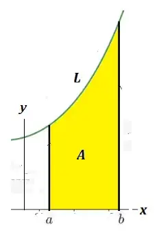

Find equation of a curve whose area under it equals product of arc length $L$ and its projection $(b-a)$ on the x-axis.
$$ A = L (b-a)$$
$$ A = L (b-a)$$
