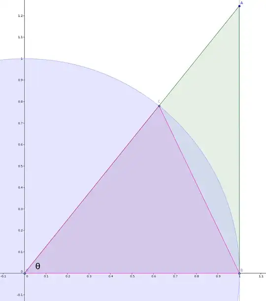

$\text{Here is a geometric proof for $\sin(\theta) < \theta$. Consider a unit circle as shown in the figure.}$ $\text{We then have that the area of the sector formed by $BC$ as }$ $$\color{red}{\dfrac12 \times OB^2 \times \theta = \dfrac12 \times 1^2 \times \theta = \dfrac{\theta}2}$$ $\text{which is greater than the area of triangle $OBC$, which is }$ $$\color{red}{\dfrac12 \times OB \times OC \times \sin(\theta) = \dfrac12 \times 1^2 \times \sin(\theta)}$$ $\text{We hence get that}$ $$\color{blue}{\dfrac{\sin(\theta)}2 < \dfrac{\theta}2 \implies\sin (\theta) < \theta}$$ $\text{The figure was drawn using GeoGebra on Ubuntu. Lets see if some one can come up with a}$ $\text{geometric/pictorial proof for $\color{green}{\theta - \dfrac{\theta^3}{3!} < \sin(\theta)}$.}$
