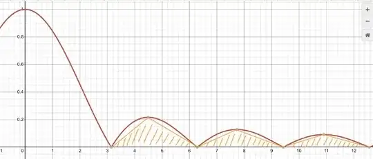

I would like to provide an intuitive graphic explanation.
Since $\left|\frac{\sin(x)}{x}\right|$ is continuous on $[0, \infty)$, thus it suffices to show the absolute divergence of the tail, namely $\int_{\pi}^{\infty} \left|\frac{\sin(x)}{x}\right| dx$.
Consider bounding this integral below by the infinite sum of area of triangles, namely the n-th triangle has width $\pi$ and height $\frac{1}{(n +1/2) \pi}$, thus the total area (of triangles) = $$\sum_{n = 1}^{\infty} \frac{1}{n + 1/2} = \infty$$ By a comparison test to the harmonic series $\sum_{k = 2}^{\infty} \frac{1}{k}$, thus the original integral diverges.
