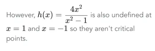

I'm trying to understand an explanation in Khan Academy on the topic "Finding the critical point".
I understand that we need to get the derivative down to either zero or undefined to find that critical point, but I don't get why we can't use use 1 in this equation's derivative. $h(x) = \frac{4x^2}{x^2-1}$ enter image description here
The derivative is $\frac{-8x}{(x^2-1)^2}$

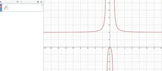

Is it because the graph itself already has undefined at 1? enter image description here

    A critical point has to be a point on the domain of the function. In other words the function should be defined at that point. Your function is not defined at 1 or -1. – Ameet Sharma Nov 14 '20 at 00:17
  • So is 0 a critical point of a function like this $h(x) = 6x^5-15x^4+10x^3$? I feel like this critical point piece is tripping me up. I've had to ask another question herelink – nvs0000 Nov 14 '20 at 11:48
    Yes, in that situation 0 is a critical point, because $h(0)$ is well-defined, and $h'(0)=0$ – Ameet Sharma Nov 14 '20 at 12:48
  • In this videolink, Khan Acad defined critical points as: "non-endpoint min or max, @ x=a, where f'(a) = 0 or f'(a) = undefined." Please help me understand why that "undefined point in Khan Acad link" is a critical point while the "undefined point in $\frac{−8}{(^2−1)^2}$ " is not a critical point. //
    I can see the graphs look different, but.. is that all we are basing it on, we have to draw the graphs to know?
    – nvs0000 Nov 14 '20 at 13:06
    if f(x) is well defined but f'(x) is not well defined, then it is a critical point. The key is that f(x) is always well defined at all critical points. But f'(x) need not be. If f(a) is well defined, but f'(a) is undefined, then a is a critical point. In your link f(a) is well defined, because the function is well defined at all x values. So if f'(a) =0 or f'(a) is undefined then a is a critical point, because we know f(a) is well defined. – Ameet Sharma Nov 14 '20 at 13:24
    Thanks so much, this comment help! To be a critical point, the selected range in function f must be defined. It doesn't matter if the derivatives are undefined. If the original f(x) is not defined, it cannot be a critical point. – nvs0000 Nov 15 '20 at 04:22
A critical point is a point in the domain of the function where the derivative is either undefined or zero. As you notice, $-1$ and $1$ are not in the domain of the function, so they don't meet the criteria.
We would say that $x=-1$ and $x=1$ are asymptotes of the function.

    @olif9837 An asymptote means that the function is undefined there. For a vertical asymptote, the function approaches either infinity or negative infinity, which are not numbers in the standard definition of calculus. Since the function does not attain a value at that point, it is undefined. – Toby Mak Nov 14 '20 at 11:57

If you have
What is $h(1)$ ? You have something divided by 0 which is undefined.
So 1 cannot be a critical point.
